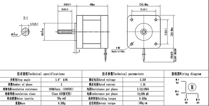

Can you post data sheets for the motor(s) and motor drivers, please?
What is connected to the dial(s)? A potentiometer, a rotary encoder?
Is it important to establish a starting position for each motor (homing)?

Thank you. I didn't have any potentiometer or rotary encoder connected as that's what I want someone else to design for me. I have no idea about those devices.. I just learned some Arduino programming to spin the motors using Arduino, power supply and a breadboard along with driver chips.
I used a DRV8825 for each hybrid stepper motor (data sheet attached, has 4 wires), located on a breadboard, along with a power supply. I had no problem rotating them.
Yes that would be the idea. I would want to have a dial to control each stepper independently of eachother and also I would want to be able to move a step or 1/2 step at a time, likely a step for one of them each time I turns the dial 1 detent and a 1/2 step for the other one each detent of the dial.
