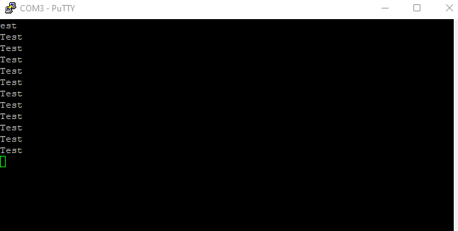

My issue is, despite having PuTTY and the Arduino set up correctly talking on the same baud rate etc; I cannot seem to get the comms working.
When running my code all I am seeing in the PuTTY window is "UStT▒" instead of "test".
Again, I have checked my baud rates and everything matches as it should do, So I am confused as to what is wrong? Any advice please?

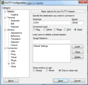

Maybe you can share a screenshot of the connection settings?
Apologies, Here it is. I have tried turning flow control off too but that did nothing :frowning:
PuTTY
And the connection type is also set to "Serial"?
It is indeed

Get rid of XON/XOFF
Use 'None'

Could you disconnect the serial adapter, close the serial monitor and try to use PuTTY on COM3 first?
I tried this earlier thinking it could be PuTTY. It works fine.
