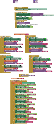

i want to send and recieve data from my phone to arduino using HC05.
my first question : is it possible or not
if yes i tried every tuto on the net and no answer
i made an app, i want to now the led status on my arduino and send it to the phone and turn on/off the led from my phone all this with the same app.
thx

my app attached

what i try to do is sending data from my app and reciving data to the same app
i'll send some pic of my HC05
thx a lot
The code that i posted is tested and I know that it works. Wouldn't it be nice to know that the Bluetooth works by itself with tested code before moving on? Then try with your app. Baby steps.
okay i'll try
but i want to add that with my code i can send to my up or receive from not both at the same time

Hello everybody
well, to make things much easier, what I want to do is : get my relay status high or low send it to my phone app and with a button turn the relay status high or low (with the same app)
thx :slight_smile:
