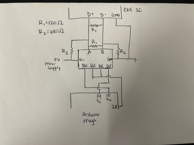

The breadboard wiring is pretty messy, but here's a diagram:
IMG_3728

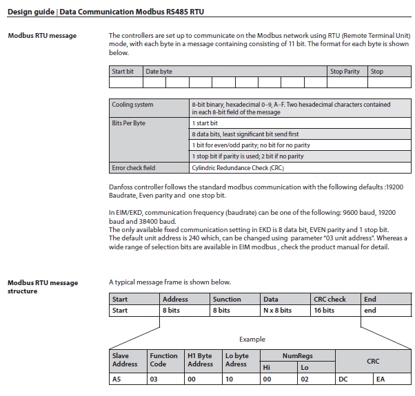

The valve controller provides the following guidance for RS485 communication.
The Mega Serial interfaces operate at TTL voltage levels but different voltage levels are used by RS485
Does the hardware between the Mega and the controller adjust the voltage levels in each direction ?
According to this datasheet the Driver Output (A, B) is 1.5 - 5V and Driver Common-Mode Output of 3V max. Not sure which is the relevant spec. The amazon supplier does not provide any relevant specifications.
@sprusr
The RS485 modules you purchased already have a 120 ohm termination. So remove the one you have next to the module
@sprusr
You also need to connect the RS485 module GND to the Arduino GND
Arduino GND originally shared a rail with the RS485 module and valve controller ground, but the Arduino ground wire started melting. I assumed it was a short.
Should they all go to common ground?
The Arduino GND need to be connected to the RS485 module GND or it wont work. The module GND also needs to be connected to the Controller ground. However, what is the controller ground? What is RGND?
If wires are melting when you connect all the grounds, then you will need to buy an isolated RS485 module.
The controller RS485 port has 3 pins (D+, D-, and GND). I don't have an Rgnd.
The controller is also supplied 24 VDC, but that is grounded separately.
So true, it is marked R7 as far as i know, but you should be able to measure the 120R and verify that it is connecting the A & B lines (pin 6 & 7 respectively on the MAX485 chip. And unless it is going to be a 2 way street it should only have one at one end.
Not bad !, still remove 2x R2 . and remove GND between EKE 1C and the module.
Then connect GND between the module and the Mega. Drop the 5v PSU and draw 5v from the Mega.
It is a Mega which has 4 hwUARTs, you should not use swSerial but one of the hwSerial ports (1, 2 or 3) to connect to the RS485 module.
No it doesn't have to. a general misconception that i have shared for some time but which was pointed out to me some time back. the RS485 does not require common GND between it's modules. Signal is transferred with opposing polarity of the A & B line and is received by measuring the polarity between those lines. GND is not required. Usually common GND does not create any issues, but it may cause a GND loop, and if there is a PSU failure in one of the connected devices this may spread to other devices.
