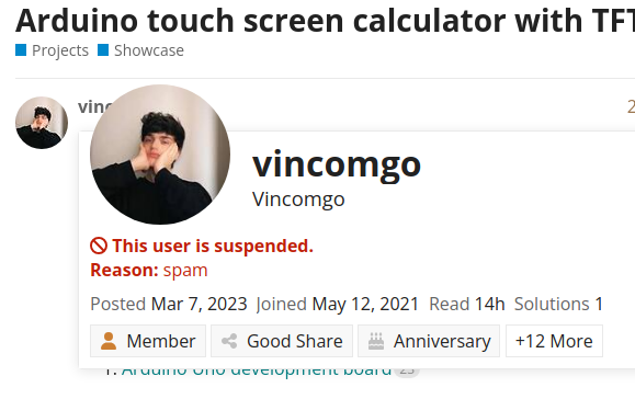

That user rarely answers, rarely produces code, and seems to spam the forum with copy/paste, without following-up.
An almost 4 year old topic, and from a suspended user; I wouldn't hold my breath waiting for an answer.
