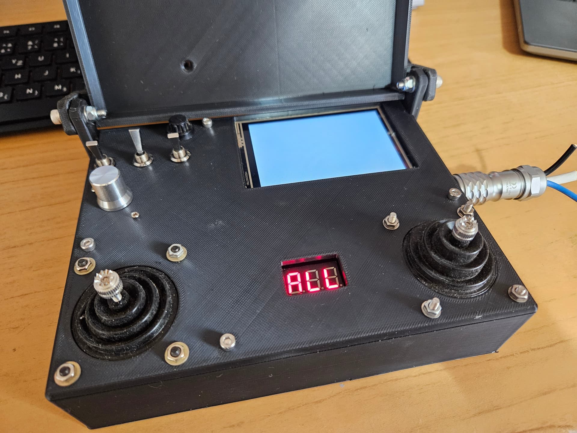

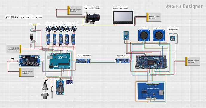

I build underwater ROV that has one Arduino Uno in ROV and another Arduino Due as a ground station. Bothe Arduinos are connected via cable (shielded twisted pair, with neutral buoyancy,150m).
It has 5 thrusters, 3 for going Up/Down and title. 2 for Forward/Backward and turn Left/Right.
Arduino Due read values from 2 joysticks and send data to Arduino Uno. Arduino Uno send PWM signal to thrusters and every 5 seconds read data from sensors (temperature, pressure, compass,...) and send it to Arduino Due. Arduino Due represent sensors data on a 3.5" TFT display.
This is a rough description of how it works.
The communication between the Arduino controllers works but the response time is poor. More than about half a second delay.

I apologize, the schematic is the final version, and the code has not been updated yet. I am still improving it. The difference is in the potentiometer and LED control.

ROV during test
New, upgraded ground station
Hi, @prudicmiha
Welcome to the forum.
You can EXPORT your circuit diagram from your CAD and place it in your post;
For a project of this depth, (pun intended), it would be better for you to draw a proper schematic, rather than cut and paste images.
