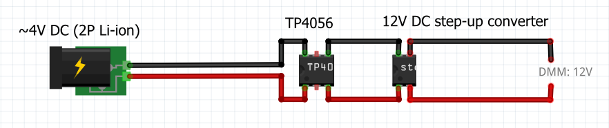

I started by using 2x Samsung 30Q Li-ion batteries wired in parallel connected to a TP4056 charging circuit such as the one here. A quick DMM test shows 4.1V on the BAT +/- terminals and the same voltage on the OUT +/- terminals; all good!
Now as my project will require a number of 12V components that will be operated via a separate relay board (the Arduino will only send 5V digital signals to the relay board), and the fact that the Arduino Uno is input rated 7-12V, I decided to use a common power supply for both the Arduino and the relay board (not connected). Only a minimal number of low-current 5V components will be connected directly to the 5V pin on the Arduino. For testing, only an LCD (like this one) is connected.

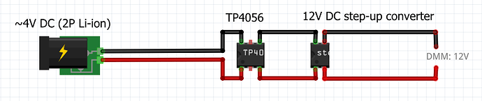

Using a DC step-up converter (like this one), I attach the OUT from the charging circuit to the IN of the converter, and DMM test the voltage out of the step-up converter: sweet!

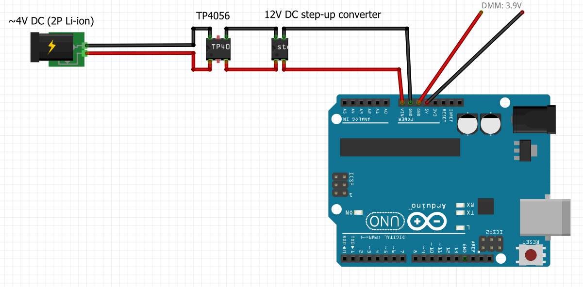

Now, wiring the 12V input to the Arduino Vin and GND pins, the Arduino powers on and executes my test code. Only the LCD display is connected to 5V and another GND pin, and communicating via I2C (A4, A5), no other components are present. Voltage test on the step-up converter OUT pins shows 4.7V. Assumption: 12-4.7=7.3V is being used by the Arduino. A little confused by this, as I expected the Arduino to take the full 12V, but as this is within input specification, I assumed it is not a problem.
Testing the 5V pin output shows 3.4V, so I assume this means my LCD is using approximately 5-3.4=1.6V? Well below its operating specification of between 3.3 and 5V, yet it functions so no complains there. However, this warranted further investigation.
Unplugging everything from the board, resetting it, and testing the 5V pin shows 3.9V. Why so little? What could be causing such a voltage drop? After a fair bit of Googling, and the fact that things still work, I would conclude that I haven't done anything REALLY wrong. Perhaps a bad step-up converter, or maybe I'm just misunderstanding how this works?

I attach schematics and DMM readings from all 3 cases I described.

So what you really need to do is connect everything as in Case 2 (Arduino connected, nothing else) and then measure the voltage at all points. Is the input to the converter/output from TP405 still ~4V? What is the voltage from Vin to GND? 4.7V? If you're putting only 4.7V into Vin then explains the very low voltages at the 5V pin.
The reason has to be that either the converter is bad or the TP4056 module is bad or being misused. Do you have the 5V (USB or otherwise) connected to the TP4056? It is supposed to be a charger after all. Your pictures don't show it.

Yes, with the minimal load being the Arduino and nothing else.
The TP405 outputs the voltage of the two batteries in parallel in all cases, so around ~4 (approaching 3.9V as my battery discharges). When plugged into 5V USB source, the TP405 outputs 4.2V (charging voltage of the batteries), even under load.
The converter outputs 12V at no load, and around ~5V +/- 0.5V with the Arduino connected. When the TP405 is being charged, the converter output voltage is slightly higher, or maybe within error.
So would the conclusion be that the converter is at fault? Any particular reason for this, especially given that the current load is more-or-less minimal, or at least lower than the 500mA it is rated for at 12V?
Either way, thank you for your responses!
With nothing connected to the Arduino and just that connected to the converter as you say the load will be around 50mA. So it appears that the converter is incapable of supplying anywhere near 500mA which is what I call faulty. I'd replace it.

You were correct about the multimeter, I have replaced the fuse and I measured the current draw by the Arduino to be around 70mA between the charging circuit and the converter, and about 20mA between the converter and the Arduino itself.
I guess I'm just having trouble with the fact that the converter produces 12V with no load, but bogs down when the Arduino is connected to it. Have you connected something else as a test load? Resistors even? Something other than the Arduino.
I think I may have mentioned it above, but I have tested other components, most notably I tried powering my relay board which takes in 12V power and 5V signal, and the board powers up but is far from 12V so any other components on it refuse to power. I have tried a 12V solenoid directly with the converter now that I know it is probably broken, and the voltage drops to about 3V and the solenoid does not operate. So I think it is safe to assume that it is the converter.
I will purchase another higher quality one and report back, at least so that anyone reading this in the future knows for certain.
Update on the new converter, it seems to be working perfectly, both in terms of powering the Arduino (with a drop in the output voltage of around 10mV, so negligible), and the 5V pin now has 5V as expected. Also, operating relays and the relay board at the same time works well without interrupting power to the Arduino, even at relatively high loads, so it seems it was the converter that was faulty all along. Thank you very much for your help!
