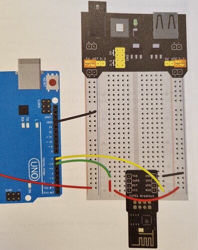

What I 'm trying to do
Send temperature read from a DS18B20 (PCB version) sensor and send the value to a REST API.
Problem:
WiFiEsp starts handing me ">>> TIMEOUT >>>" messages after a few hours (it differs) of running flawlessly. I've not seen it run longer than about 14 hours but that was only once. It always stops working at some point and I want this to be 100% stable.
I've been working on this for a few weeks now and I've searched through forums and many have similar problems but I have not found a fix that works permanently.
I'm powering the Arduino via USB and the ESP8266 via a 9 Volt battery via the 3.3v pins of the breadboard Power Supply Adapter.
Update 2022-01-25:
The first illustration I uploaded was completely unrelated so I've updated that now. Also as of writign this I'm a "new" user and can't embedd more than one image so you'll have to look into the history edits to see the first illustration.
The error log

I'm running ESP8266 on baud rate 9600 (according to the example in the book).
I'm running Arduino board on baud rate 19200 (to not conflict with the ESP).

Things I have tried:
- Adding the client.stop() on the WifiEspClient actually made things a lot more stable per loop (the result is the [WiFiEsp] Disconnecting 3 in each loop). Before I added this about 25% of the http-requests failed sporadically. The client.flush() is probably useless, yes, but it's not the problem either.
- I've checked available RAM in the loop (via the function as written in the sketch) , it's 100% constant if I would print that on the 19200 serial monitor. It's around 1.1k free so that It's not the issue.
- I tried running both Arduino Board and ESP8266 on every baud rate there is in different combos. The most stable thing seems to be 9600 for the ESP8266 so I'm sticking with that.
- Adding delay(100) here and there in the actual HTTP-request seems to also make things a bit more stable. I have no idea why but read somewhere that baud 9600 is very slow and can be overflowing the WiFiEsp lib easy so... yeah.
- Tried changing client.println("Connection: close"); to client.println("Connection: keep-alive"); - Did nothing but add more errors.
- Added a reset of the whole Arduino board at an interval, sure, it works but it doesn't solve the issue, it's just a really crappy work around.
My question
What would be the next thing to investigate to try and solve this?
I know the API is a .net build and maybe sometimes that is recycling the application pool on the server. I'm thinking maybe the recyling could cause some longer response times but if that so, there must be a way of handling that in the sketch, right?
