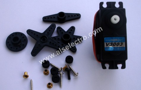

Servo Motor
V3003 ( PLASTIC GEARED )
Operating Voltage : 4.8-6.0V
PWM Input Range : Pulse Cycle 20±2ms, Positive Pulse 1~2ms
STD Direction : Counter Clockwise / Pulse Traveling 1500 to 1900µsec
Stall Torque : 3 Kgf.cm(41.3 oz/in) at 4.8V, 3.2 Kgf.cm(44 oz/in) at 6V
Operating Speed : 0.2 sec/ 60° at 4.8V, 0.18 sec/ 60° at 6V at no load
Weight : 38g (1.27 oz)
Plug Available : FUT, JR

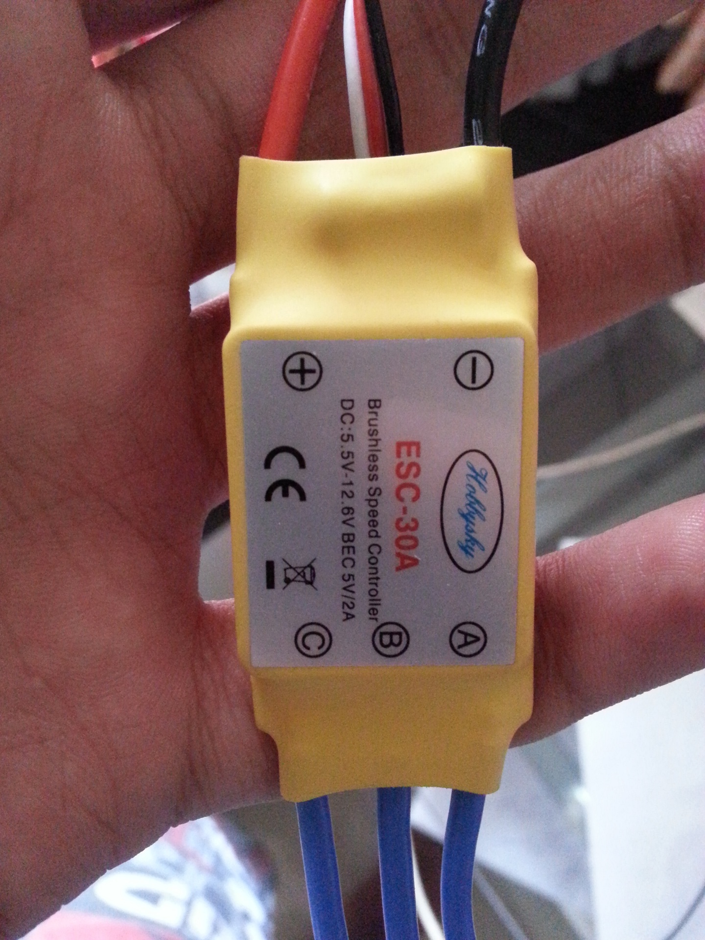

ESC
Hobbysky ESC 30A
DC:5.5V-12.6V
BEC 5V/2A

Is it okay to connect the red wire from the ESC connector to the arduino's +5V pin?Will it power up the arduino ?Is it also possible to run the servo from the same battery by splitting the red wire from ESC for both arduino and Servo?
No. The ESC sucks too much current.

It IS a power out wire.
The ESC has a Battery Elimination Circuit (BEC) with can source 5V @ 2A. It's VERY common to use this power for controllers and servos.
2A should be okay to power both the Arduino and the servo.
VinayV:
Yes. This is want the 5V BEC is for.
VinayV:
Probably (take that as a yes). You don't want the 5V to pass through the Arduino board. Split the power from the BEC to both the servo and the Arduino.
The main problem with powering the Arduino and the servo from the 5V BEC is the servo could cause problems for the Arduino. (I do this sort of thing all the time though.)

Just to be clear, we're talking about the red wire on the servo type connector of the ESC?
There's considerable debate about this. If you have more than one ESC, it's a good idea not to have the various BEC outputs connected. Lots of voltage regulators don't work well when used in parallel.
If you are powering the Arduino from an external source through the barrel jack, then you wouldn't want to connect the BEC to the 5V pin of the Arduino. In this situation, it's okay since the BEC is the Arduino's only power source.
I'm not so sure if it's okay to leave the BEC connected while the Arduino is connected to a PC via USB. I generally disconnect the BEC when programming the Arduino.
