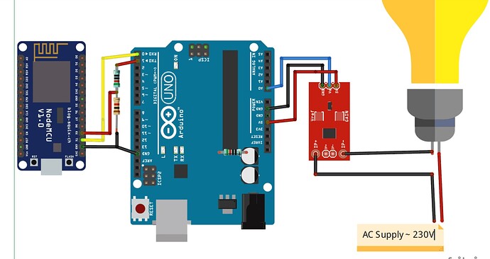

Arduino Uno Board and NodeMCU 12E communication
Hi there
i want to send data from Arduino UNO to NodeMCU and then to MQTT server. I have both codes for UNO and NodeMCU but data on mqtt server are different. NodeMCU get data which are different from data on UNO. Data is bigger or zero or sometimes late... i dont know what to do
does anyone knows?
here are the codes for UNO and NodeMCU

as you see in this code i am sending data "wattp" but these data's are different on UNO and NodeMCU and dont know why
i want to send value "U" from arduino uno through nodemcu on mqtt server
please help

you are telling me to drive airplane..but i dont know..i am looking for help...as i wrote, code for UNO is working and values are ok...but when i publish values through nodemcu on adafruit, i got different values...maybe there is problem with connection btwn UNO and NodeMCU..i connected like on picture..is it ok and is there any other way of connection?
I am not telling you to drive an airplane, if the other code is yours the Serial communication is not beyond your grasp.
the main problem with your reception code is that you just start reading data, and read the first 5 bytes that arrive and expect them to be the first bytes that you intended to send. If you connect the Uno to the serial-monitor and press the reset button you'll see that at first quite a lot of garbage values are being put out, and that is probably what you are receiving. The tutorial clearly explains that and it explains quite a few other things as well, it just seems a bit more complex because the code receives in a 'non-blocking way' and so your looks simpler, and in some way it is (wait 100 ms, and read all after that in chunks of 5 bytes) but it just doesn't quite work like that. you will need to put start and end markers in transmission (or some kind of header at times can be enough) If you then receive in a blocking or non-blocking way doesn't matter all that much (do mind the wdt reset though on an ESP) in your case. In some cases non-blocking is better, in most cases blocking is also fine, and in rare cases only blocking will work.
i told you driving an airplane because i am beginner here and i found this code here
and i copy it and tried but recieved only 0.0 on mqtt server, but on arduino uno i am receiving good values
if you have time you can see those codes and tell me what to change
and yours explanation is good and now i understand something

also want to tell you this..on this link i found this code
as you can see i was reading and reading and modified this code which was writing for one sensor...i modified for 3 sensors and for calculating total amps and total watts
for me is huge success, so i am going further
but have problem now and after reading lot of pages i dont know how to modified code for nodemcu to get UNO value "cetvrta" on NodeMcu
i found something on pages you sent me....is this important for my code?
