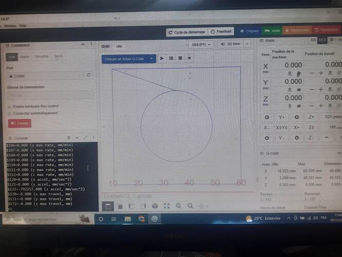

my cnc shield connected to arduino uno is showing 0.6 v as input voltage while i m using 12VDC source , is it a short ? or something wrong with the arduino card ?
photos are available

the cncjs is showing ok but physically the motor is not working
