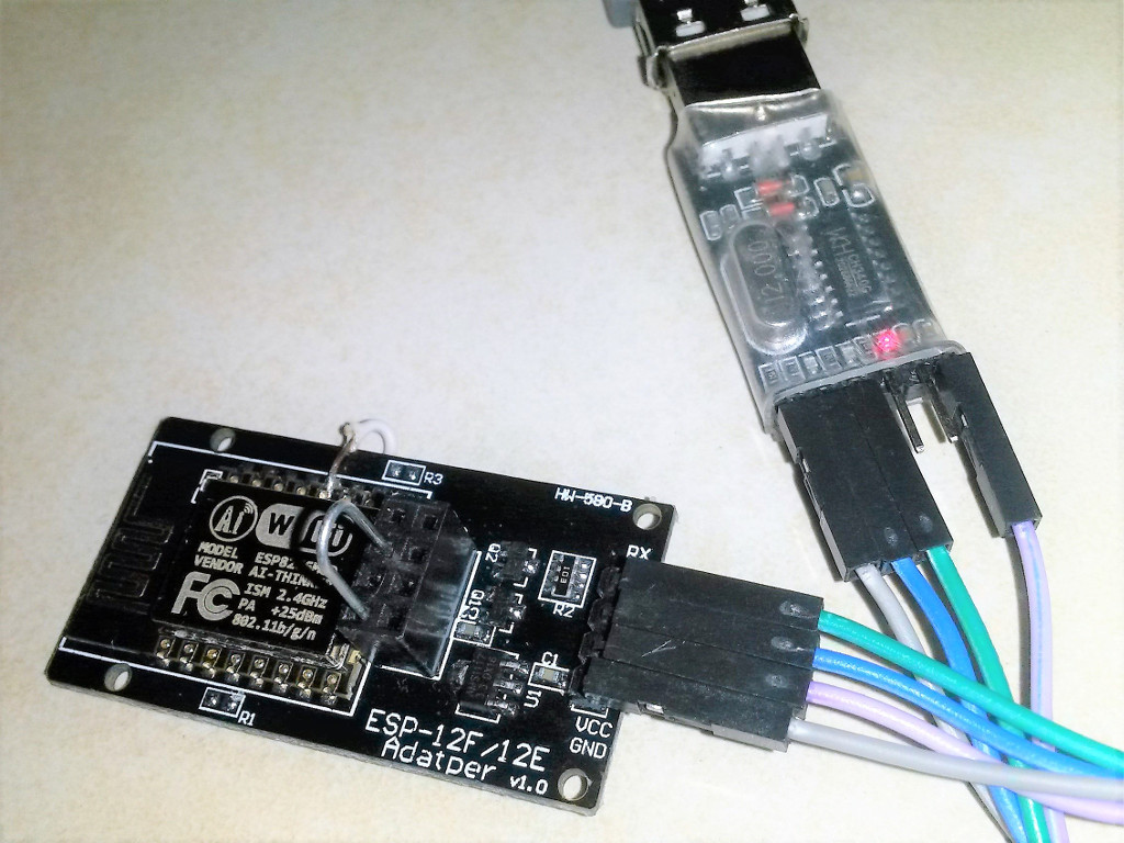

they breakout only rx/tx. no io 0 or io 2. to flash the esp8266 a 3.3 V USB to TTL adapter is needed and jumper to ground io0.
I have this version of 5V adapter board with ESP-12F glued. io 0 and io 2 are not connected to header (I patched io 0)
floresta:
In other words you are using an esp-01 with a level shifter, just as has been recommended. Your esp-01 inputs are not being fed 5 v with your setup.
Don
True, its not fed by 5v its still 3.3V , but adapter can be connected to 5v which has higher current rating then 3.3v output and so ESP-01 works correctly. And its so cheap and compact (at least in my project) so i wouldnt bother with creating my own level shifter
