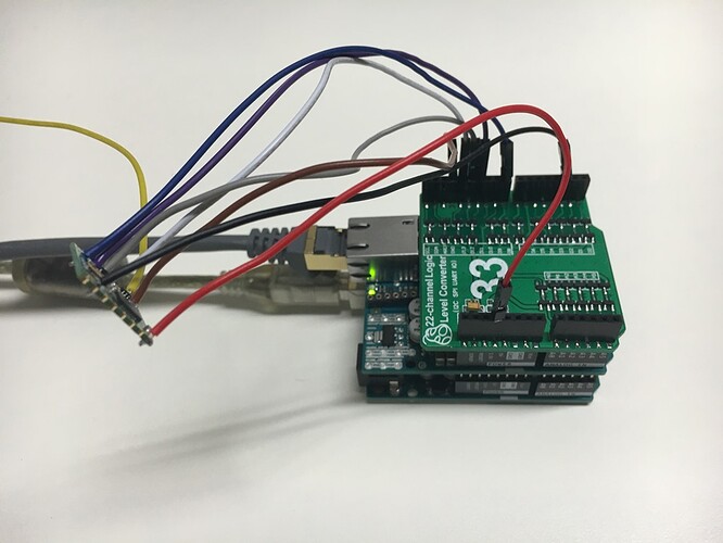

Arduino Uno, Ethernet Shield 2, RFM69HW -> MQTT -> OpenHAB
Hi
This is a programm to receive a message over the RFM69HW and push it to the mqtt server.
My code crash at some point. I do not figure out where and why. Can somebody help me?
It works 2,3,3 times and then nothing happened.
