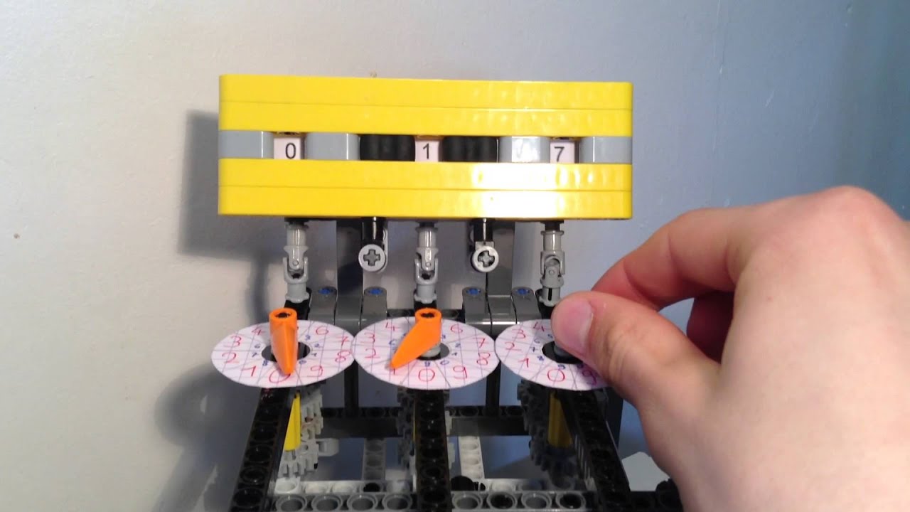

You don't need to limit yourself to a native datatype.
You could instead use an array with one element per digit, and use this technique:
I know the video only shows how to add, but you can build up other operations from addition.
For example, multiplication:
75 * 24 can be computed as 750 + 750 + 75 + 75 + 75 + 75
This way, you can deal with very large numbers.
You can then write code to keep track of the position of the decimal point.
