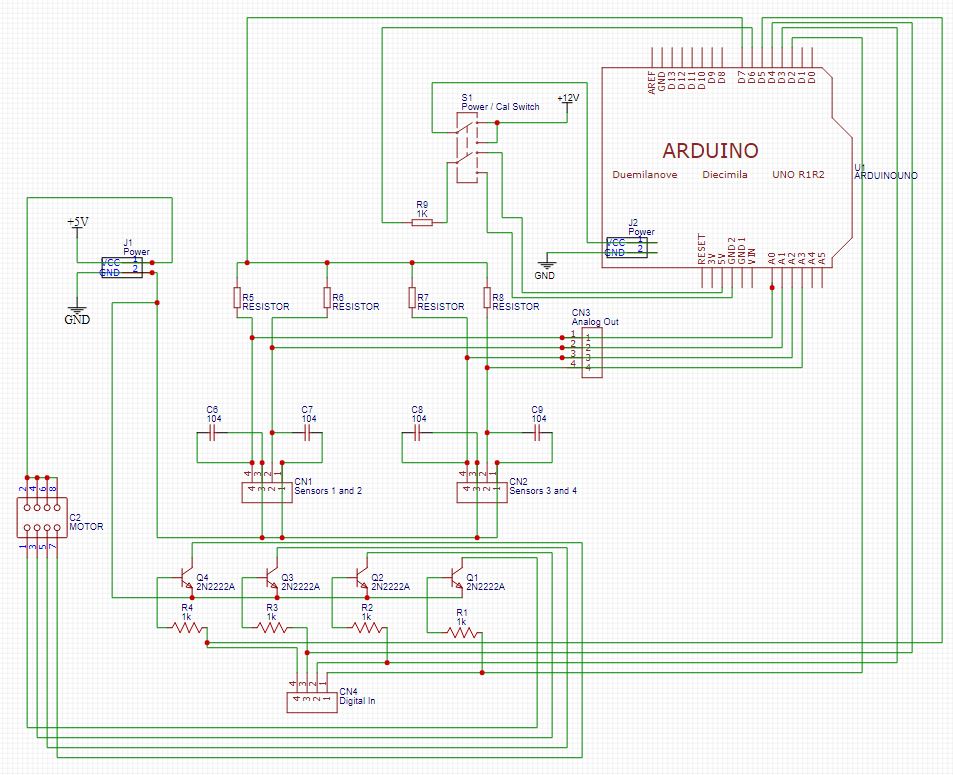

Hello,
I am a newbie and trying to make a plant watering system using Arduino UNO. Below is the code I used.
When I first switch on power, it works fine. After that it never turns on the pump even if the soil is dry. But if I switch it off and back on, it works for one more time. I tried to read the serial monitor, but the problem is, when I connect the USB cable, it starts working again.
I have kept a delay of 5 hours and the power to the sensor module is OFF before it reaches the 5 hrs to minimise corrosion of sensor probes.
I have also added a Cal switch to bypass the 5 hrs delay.
Any help is appreciated.. Thanks!!

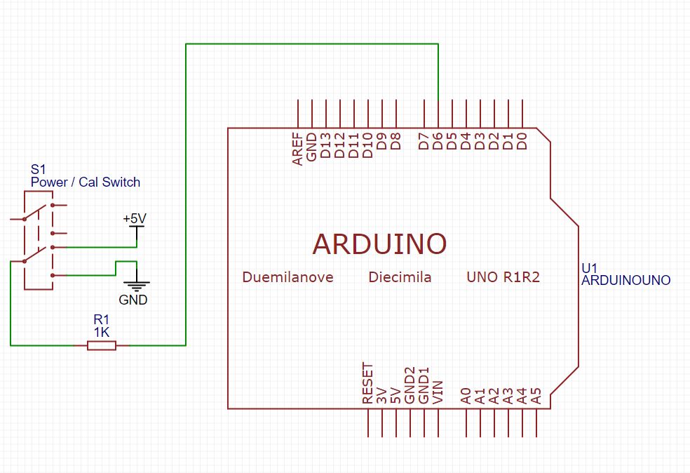

Did you use pull-up or pull-down resistor for pin 6 ?
IoT_hobbyist:
Yes I do

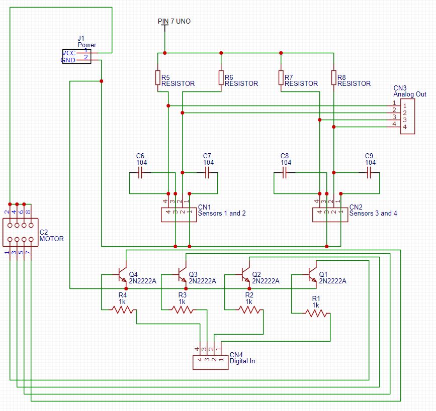

:slight_smile: I mean the switch has two positions to choose between high and low using pull up / pull down resistors for pin 6
TomGeorge:
Sure.. please find attached and thanks for the response

I am sorry, but what is the below line for? or, did you mean LOW?
digitalWrite(7, HIGH); // Shuts them off..
Which now makes sense with a schematic.
But unnecessary: spst switch to ground from pin with pinMode(7, INPUT_PULLUP); would give you definite high and low for open and closed respectively. And I think IoT_hobbyist was expecting a spst which is what prompted his or her question.
You resistor's not actually a pullup in the sense meant here, whose purpose is to steer the pin in a known direction when the switch is open. I'm not sure why you have a resistor there anyway.
Can you draw and post a picture of your entire circuit, showing power supplies and sensors and motors and labels and pin names.
Please;
Post a link to spec/data of your sensors.
Post a link to spec/data of your motor.
Why so many 2N2222 transistors for one motor?
Have you considered using a single MOSFET to turn the motor ON and OFF.

The schematic is attached.
Connectors CN1 and CN2 are connected to the 4 sensors and goes to A0, A1, A2, A3 of arduino through voltage dividers.
Connector C1 is connected to the pumps (PINS 2,4,6,8 are common +VE and PINS 1,3,5,7 are the GND to each pump driven through the 4 transistors 2N2222).

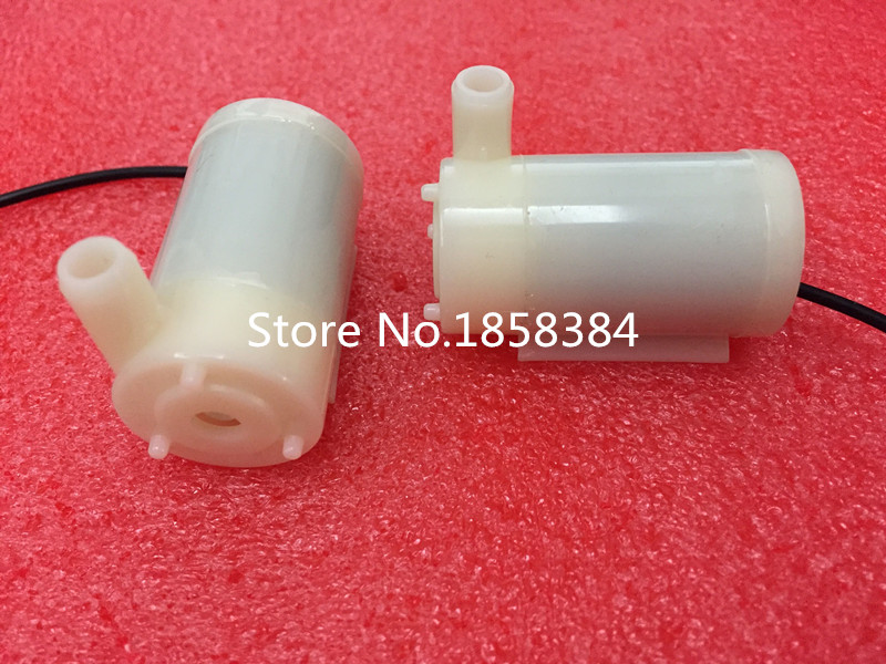

Motor(Pump) details are in the below link
Pump

My power supply is a 5V 3A adaptor. In order to power Arduino, I am using a DC-DC step up off the 5V supply. DC-DC step up is shown in the below link
Step Up
Hope I have provided all the required details..

If everything runs on 5V, why are you stepping 5V up to 12V, then feeding it to the Arduino barrel jack where it's stepped back down to 5V? How much current do the sensors draw? Four of them may be too much for one output pin. I don't see kickback suppression diodes across the pump motors. What are the values of R5 ~ R8?
Is S1 really a double pole double throw switch?
Why have a switch that does nothing in the 12V supply?
Tom... :slight_smile:

Pump;
