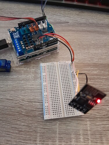

I'm having trouble with uploading my code the arduino, what i want to do is to steer a servo with a slider on the remoteXY app
This is the error message:
avrdude: stk500_getsync() attempt 1 of 10: not in sync: resp=0x40

Here is my setup, the TX and RX pin are disconnected and on top of the arduino uno is a Rev 3 motor shield which i connected the servo to on OUT5

Hi @ffssfsdgsgdfdfdfhdhb.
I see some wires connected to those pins in your picture, but it doesn't show what is on the other end of the wires. Pins 0 and 1 are used for communication with the computer so connecting anything to those pins can cause the upload to fail with the error messages you shared.
Why did you ground the reset pin?
I was just trying to solve it, i changed it back to 2 and 3. Still doesn't work. The ESP blinks red and blue for like 2 seconds then turns red and after that i wait like a minute to get the same error message
I followed a circuit setup i found on the forum, I added a new circuit specifically made for my setup now. But honestly, i don't know.
@EmilyJane spotted the true cause. Disconnect the reset pin from ground and then try uploading again.
This is done in a case where you want to use the UNO board as a simple USB to serial adapter to the ESP-01 module instead of as an Arduino board. That is done either to send the ESP-01 module AT commands or to upload a sketch to the ESP-01. Grounding the reset pin disables the ATmega328P microcontroller on the UNO board in order to avoid the chance of it interfering with the communication between the ESP8266 microcontroller and the computer.
But your sketch is meant to run on the UNO so you must configure your circuit to allow the computer to communicate with the UNO.

ok so bad and good news. I managed to get the code uploaded, but when trying to connect my phone to the esp8622 wifi there is no wifi called "RemoteXY". The only thing showing up is called like AI_Thinker which is some what linked to the esp when searching it up atleast.
Your circuit seems to have other mistakes as well.
The ESP8266 is a 3.3V device. Feeding it a 5V signal (the Tx of the Uno) can damage the ESP8266 processor; you need a voltage divider between the Tx of the Uno and the Rx of the ESP8266.
You have powered your ESP8266 module with 3.3V. Is that the spec of the module? Or does it require 5V and the module's onboard voltage regulator brings that down to 3.3V? Check the specs of your module.
@ffssfsdgsgdfdfdfhdhb there is a diagram of the circuit you should use in the RemoteXY documentation:
https://remotexy.com/en/help/start/arduino-esp8266-ss/#:~:text=Step%204.%20Connect%20ESP8266%20to%20Arduino%20Uno
I see you also did a silly configuration of the communication interface. If you are going to use pins 0 and 1, then you should select "Hardware Serial" from the "Connection interface" menu in the RemoteXY Editor:
https://remotexy.com/en/help/start/arduino-esp8266-ss/#:~:text=Connection%20interface%3A%20Hardware%20Serial
The documentation explicitly says not to use Software Serial:
https://remotexy.com/en/help/start/arduino-esp8266-ss/#:~:text=you%20need%20to%20use%20Hardware%20Serial%20for%20communication
Note. The ESP8266 is configured with a default baud rate of 115200. For this reason, you need to use Hardware Serial for communication. Software Serial cannot run at this speed.
Did you read the RemoteXY documentation??? If not, do that.
I did see that yesterday and i did change it correctly
The ESP uses 3.3 volt.
Thanks for letting me know.
Alright, so i got the whole rig working thank you so much. I will look into getting a voltage divider for the tx pins so it doesn't damage the esp. I also connected the tx to tx and rx to rx, which is supposed to be flipped around.
