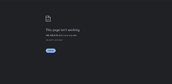

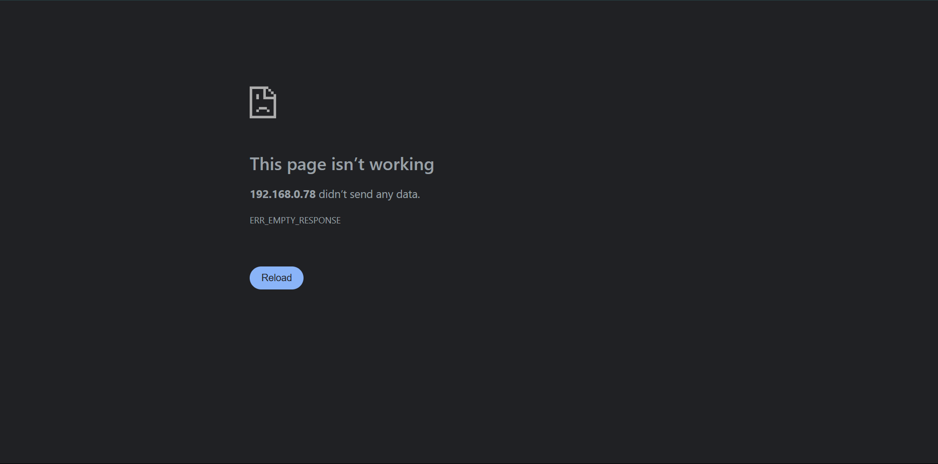

I recently got a new arduino uno r4 wifi and I wanted to try the wifi examples. Whenever I try one of the web server examples the arduino says it is connected to wifi but I can't get on to the server. I set up a guest 2.4 wifi called Arduino and have my board and computer on the same guest wifi.
Post the code in code tags and the serial log also in code tags

i am using a sample sketch
i tried a different sample sketch that doesn't have the thing about telnet but it has the same error when i try to open it in chrome

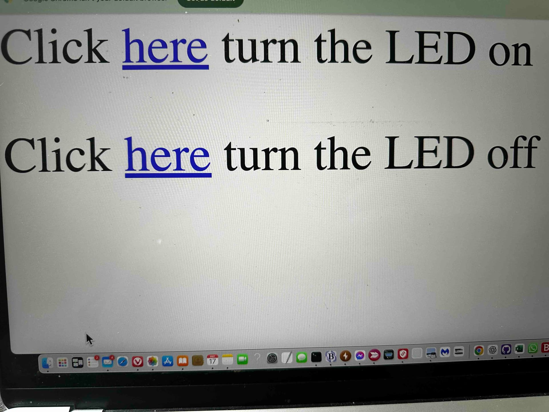

What board are you using and selected in the Board dropdown so I can try it here.
That sample is ancient and for a specific board. Are you still using the UNO R4?
The sketch works just fine.
Please upgrade the firmware
Attempting to connect to Network named: MySSID
SSID: MySSID
IP Address: 192.168.x.xxx
signal strength (RSSI):-54 dBm
To see this page in action, open a browser to http://192.168.x.xxx
new client
GET / HTTP/1.1
Host: 192.168.x.xxx
Connection: keep-alive
Cache-Control: max-age=0
Upgrade-Insecure-Requests: 1
User-Agent: Mozilla/5.0 (Macintosh; Intel Mac OS X 10_15_7) AppleWebKit/537.36 (KHTML, like Gecko) Chrome/136.0.0.0 Safari/537.36
Accept: text/html,application/xhtml+xml,application/xml;q=0.9,image/avif,image/webp,image/apng,*/*;q=0.8,application/signed-exchange;v=b3;q=0.7
Accept-Encoding: gzip, deflate
Accept-Language: en-US,en;q=0.9
client disconnected
new client
GET /favicon.ico HTTP/1.1
Host: 192.168.x.xxx
Accept: image/avif,image/webp,image/apng,image/svg+xml,image/*,*/*;q=0.8
Referer: http://192.168.4.149/
client disconnected
Here is what the browser shows
