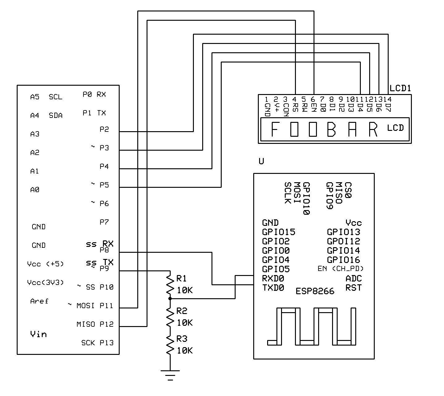

Here is how I connected my Uno to an ESP8266 using a voltage divider on the serial port. It would be the same for ESP32. The resistors could be 1K (R1) and 2K (R2) or 10K and 20K or any values as long as the ratio is 1:2. This is using software serial where Uno pin 8 is RX (to ESP TX) and Uno pin 9 is TX to ESP RX.

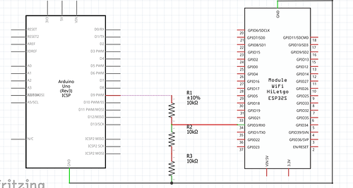

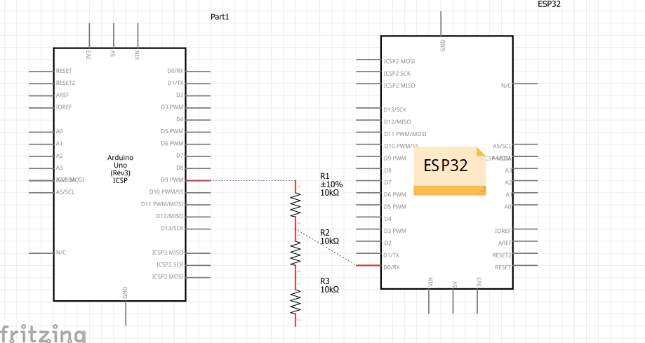

I've made a circuit but I don't know if it's wired properly. If you have time, can you please check my wiring and see which one is correct?
This is the first option: https://i.imgur.com/8QzXTi0.png (I have two 10k resistors combined in series, the first ones from left to right. I watched a few tutorials yesterday and I guess I nailed them. I'm not really sure if the third one should be placed there. On this way I have one (two 10k) 20k resistor and one 10k. The platform where I created the circuit didn't have ESP32 microcontroller on it so guess that the upper Arduino is an ESP32)
This is my second option: https://i.imgur.com/uvZR8Qp.png

Here is how to do it with the 10K in series to make 20K. Both of your diagrams are missing ground.

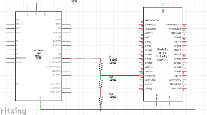

I was struggling with "translating" an electronic circle to, let's say, real life circle and that's why I couldn't wire it properly I guess. I downloaded a software that "translates" an arduino project to a circle and I got your circle on the end.
Can you approve if the wiring now is correct?
I uploaded my two images but if you don't want to download them, here's a link for them:
  1. Arduino wiring: https://i.imgur.com/LHguSmk.png
  2. The circle I got from 1): https://i.imgur.com/lKQFxVD.png
Once again thank you and the others who replied, you're a life savers :smiley:
The diagrams look good except you left out the grounds.

Thank you sir, I finally managed to do it. God bless you and everyone that helped me :smiley:
For the last time, this is the correct version, right?
Looks right. Glad you got it working.
