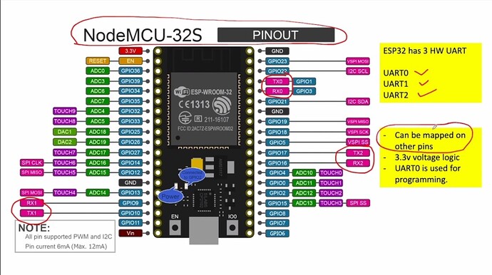

In the above image
We have here 38 pin ESP32 model which has 3 UART labelled, from which
The GPIO 1 & GPIO 3 got finalized for serial communication which is shown in the image below
Now suppose if we want to take GPIO 9 & GPIO 10 into the account for serial communication with Arduino boards like MEGA or UNO or NANO etc
So is that a good choice ???
Ref. YouTube Link is here from where I got the snapshot from above pic !!

Can we finalize GPIO 9 & GPIO 10 for serial communication between ESP32 & Arduino via level shifter???
No issues with that ??
Please comment !!! :slight_smile:
Try this:
No, don't use gpio9/10 ( see here why )

on the ESP32 U0UXD is used to communicate with the ESP32 for programming and during reset/boot. U1UXD and U2UXD hardware serial ports are available for user projects
