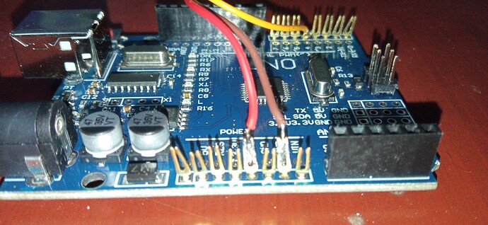

Hello,
I am using an Arduino UNO R3 (photo attached) clone for my project. Using Arduino IDE for coding. I wrote a simple code to rotate a servo from 0 to 90 degree. The problem is when I use jumper cable for connection of servo motor (SG90) to Uno, it is working properly. But when is solder servo at UNO it rotate 2 to 3 time then stuck and not working. It happen many times. I used a 12V 1.5Amp adaptor as power supply. I have checked the connection, UNO board and servo all are okay but when I solder it it stop working.
Please share, if you have any solution or help me to identify the problem.
I am curious to know why have you soldered the wires with edge connectors to ruin the UNO Board?
To work with Arduino UNO board, you need to follow some guide lines like:
Do not short the edge connector pins.
Do not solder anyting on the board unless you know what you are doing.
Do not use the 5V-point to drive power consuing devices
To what? The Arduino via the barrel jack? It will still be using the Uno's +5V regulator to power the servo via the +5V pin, which you should not do. The servo needs its own +5V supply to operate reliably over time.
Plus, that soldering job looks pretty sloppy if I'm being perfectly honest (blown up 4x on my 55" monitor).
At that point, I would pull out the remains of the headers and solder directly to the board. You could have done that while retaining the headers since the board has holes adjacent to the headers for just such a purpose.
I have an to perform an specific task. In which I just have rotate a servo. No other load on arduino apart from this. It's an UNO smd, I have perform same operation on THT. that was working well.
For test purpose, you can drive N unloaded SG90 Servo by the 5V-pin of UNO for a short period, and yet it is not recommended.
Adaptor to power the Arduino via barrel jack. I made the pins a little bit sloppy to prevent sorting or bridge formation with other pins.

There's no magic here. Either you have bad soldering or there is some notable difference in wiring that you didn't describe, length for example...

  • Fix this foolishness else you’ll be buying a new Arduino, maybe a PCB too. :scream:
Since you starting damaging the board :), I think it would be better to unsolder all this pins at all:
uno_solder
This will give you a row of holes in the board where it will be more convenient to solder wires without fear of adjacent pins shorting with each other.

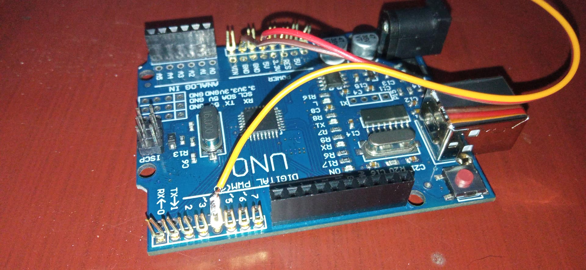

I have identified the problem.
Hypothesis:
  1. For digital signals (like the PWM signal controlling the servo), even small amounts of noise or reflection can cause issues. Longer wires might reduce such problems by allowing better physical separation from noise sources.
  2. The resistance of the wires can cause voltage drops, particularly if the wires are thin or the connections are not optimal. Longer wires can sometimes compensate for this by reducing contact resistance, provided the wire gauge is appropriate.
So, I just increased the wire length and it started working properly.
It looks as complete nonsense for me... Long wires can be a problem. For short wires to introduce distortion - this is the first time I've heard of it.
I think there's something simpler here - when changing the wires, you simply re-soldered some bad contact.

It was nonsense for me too because I faced this simple problem and couldn't find any solutions. However, this one works, so I'm sharing it. Secondly, no damage to the board happened. If something looks different than before, it doesn't mean it is damaged.
There was a poor connection on your previous attempt. Any other conclusion is nonsense.
Same thing happen many time and only one things is work. Now what can I say.
