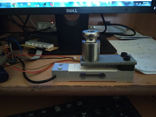

I have been using these library files and sketches, but the readings are not accurate. I used calibration sketch to find out calibration factor. Even though there is no weight on load cell it's indicating non zero value but it's somewhat close to zero and whenever I place the 200 gram load on cell, its indicating 195.67 or 196.67 or something close to 200 but not accurate enough. Moreover, it's indicating different readings at different positions of weight on load cell.
It's a humble request to all of you to help me in this regard considering to get accurate readings.
Thank you.
Load cells are not linear near zero load, try putting a fixed preload of about 1 kg on it to get up into it's linear region, THEN calibrate. I always used 2 ~ 3 % preload, which would be 0.8 ~ 1.2 kg in your case.
200g is only 0.5% of 40kg. Is that within your load cell's advertised accuracy?
NOTE: Keep the preload on the scale while weighing the 200g.
Hello Sir,
Thank you for the quick response.
As you suggested, I followed with 1 kg load for calibration. But still the readings are not accurate enough. Moreover, whenever I slide the weight and put it at a different position on the load cell, the readings are changing.
vamshich:
Perhaps your expectations are unrealistic. Have you done an analysis to confirm that the total of all error sources in your setup is small enough to support your desire accuracy?
Makes sense. Assuming a bar load cell supported at one end, moving the weight to different positions will result in different bending moments.
No Sir, I haven't done any analysis considering error sources. If possible, can you please elaborate the process of analysis, so that I will do it.
Moreover, how can I make the readings uniform even though there is a sliding of weight on the load cell.
Thank You.

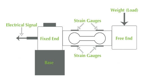

Is your setup similar to this?
Do you understand how bar load cells work? Do you understand bending moments? If yes, then it should be obvious that moving the load along the bar will produce changing results.

No Sir, I haven't done anything to confirm that it will meet the requirement given the components and other factors. Just I have taken CZL-601 (40 kg) load cell and interfaced with Arduino via HX710B IC. Then I calibrated it 200 gm weight and executed examples.
Can you please shed some light on how to confirm that it will meet the requirement given the components and other factors?
No, my setup is different. I attached the image to this message.
considering bar cells, I do know how they work. It makes sense of bending moments. But I am looking on how to attain the target of making uniform readings.
Thank You.
vamshich:
Seems like the Load Cell and the Diff Amp / ADC will be the largest potential error sources. Read the datasheets. What do their specifications say? As a quick and dirty estimate, I'd add their individual 3-sigma errors in a "Pythagorean" manner -- i.e. Total Error = sqrt (Error1 ^2 + Error2 ^2)
OP's image properly posted so we don't have to download it:
That setup will have behave exactly as the picture I posted. The response from the load cell will vary as the weight is moved along the bar.
Maybe more averaging?
