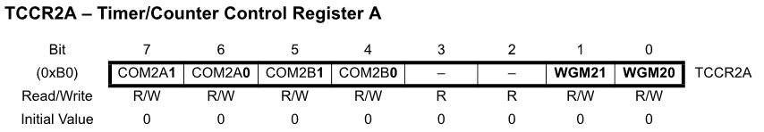

2. TCNT2 stands for 8-bit "Timer/Counter Module - 2" or TC2 of the 328P MCU.
3. In order to program the TCNT2 Module, the following registers are needed:
