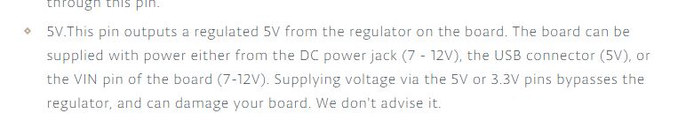

Should it be a good idea to power the Arduino Uno via de 5V pin ?
I read somewhere that it is not recommended, but it is good to connect the output of an 7805 regulator directly to the 5V pin to power on the Arduino Uno ?
(deleted)
There are some regulators that are not happy (i.e. fail) when the output is reverse driven with 5V; their datasheet showed adding a diode from the output (anode) to the input (cathode) so that the input didn't see less than ~ 0.5 to 0.7V volts below the output.
I believe this was a problem on early Mega2560 boards when folks tried powering the board from 5V on the Power Header. I wrote about this years ago, one can probably find it in the Old Forum (the one that is read only now).
Take a look at the 5V regulator on your board, and look up it's datasheet to see if a diode is recommended for protection.
See Figure 13 on pages 12, 13 here www.ti.com/lit/ds/symlink/lm1117.pdf

If you have a stable, smooth 5V source, then yes this is fine.

The fuse protects the power supply, not the Arduino.
@spycatcher2k So the recommendation is to power it via the 5V pin, with 5V regulated voltage ?
