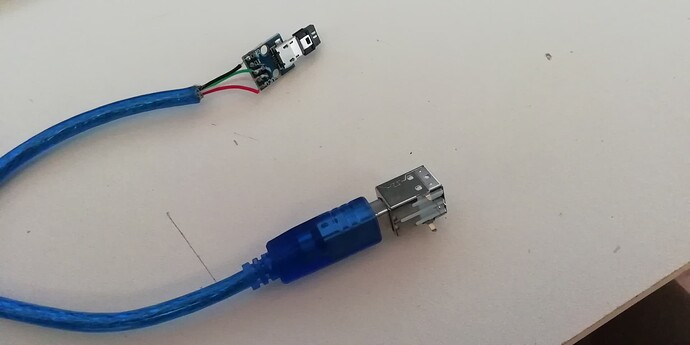

Hi all, I tryed with some of this USB micro breakout board but the Uno doesn't open a USB port on my Linux PC. Whati is wrong? Green wire (Data+) on D+ adapter pin. Thanks
Shouldn't the ID pin on the breakout be connected to ground? Or does that only matter for USB OTG?
Tested with ID pin to GND but no success...
Anything from dmesg when you plug the cable into your PC?
Is it possible that you've got D+ and D- backwards?
Have you successfully connected some other device using just your black (micro) usb cable?
Some cables are power-only, missing data wires…

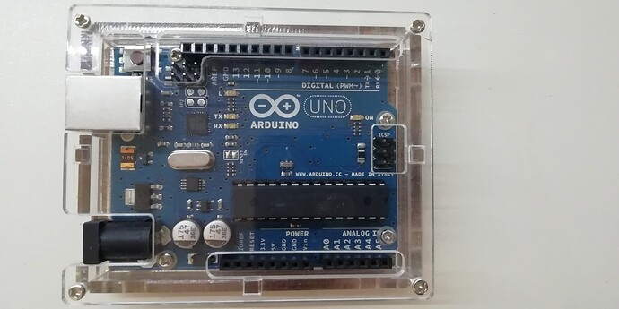

According to the photo, your Uno is not original, but a clone. I see it has a CH340 chip as a USB-UART bridge. To work with this board you need CH340/341 driver to be installed in the system.
https://learn.sparkfun.com/tutorials/how-to-install-ch340-drivers/linux

Anyway, the same clone board is correctly recognized and works just fine if I plug the USB type-B directly to the board, so the issue I suppose is in the 'bridge' shown in the photo. I tested with another micro USB breakout and different USB type-B cables but without success. Tested the same way with an original Arduino UNO

My conclusion is that your USB-A to mini cable is no good.

Yes, the problem was a faulty USB-A to micro cable ... Sorry for wasted your time ...
LOL, no problem.
It always the thing that couldn't possibly be bad.
