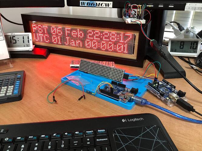

Attached is a picture of the clock to display local and UTC time from a GPS. Next are the regular UNO and the REV2 boards I've been using for these tests..
I want to remove theseconds and add sunspot number on the large display. I have all sketches worked out to get the WiFi sunspot number and parse the data. Just need to add WiFi to the large clock board. For ham radio.

The other option is to use my MKR1000 WiFi and a level converter to add to my clock nano.
