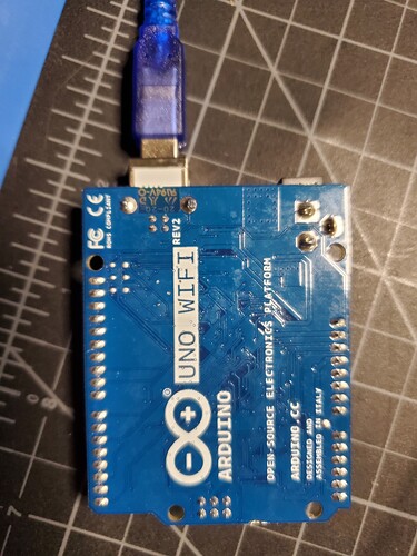

It is a Uno WIFI Rev2. I'm using the correct Board selection and port. I have four of those boards and they all have the same upload error.

If your board is not recognised, the first suspect would be the cable; if not mistaken the Uno WiFi Rev2 uses microUSB and you might be using a charge-only cable.
I have attached pictures of my wifi board.

The connections are not an issue since I can swap an Uno and WIFI board using the same port...
I just change the board/port in the tools section of the IDE.
I sent you an email with pictures of the board. They both use the same type of connections.
This is wrong for the Uno WiFi Rev2. You'll have to install the megaAVR board package using board manager if you haven't done that yet.
It will give you two additional boards in the tools → boards menu, the Nano Every and the Uno WiFi Rev2. Select the Arduino Uno WiFi Rev2 for uploads.

I was able to select the correct board after I started the thread and this is the error I'm getting.

avrdude: usbdev_open(): cannot open device: Permission denied
avrdude: jtag3_open_common(): Did not find any device matching VID 0x03eb and PID list: 0x2145

Maybe the solution is in linux - avrdude: usbdev_open(): cannot open device: Permission denied - Arduino Stack Exchange.
Found by googling avrdude: usbdev_open(): cannot open device: Permission denied - Google Search
That was the link I had found and had not re-run that script. ran it and at least I am getting it uploaded...
I appreciate all the help you gave me...again thanks. Rick
