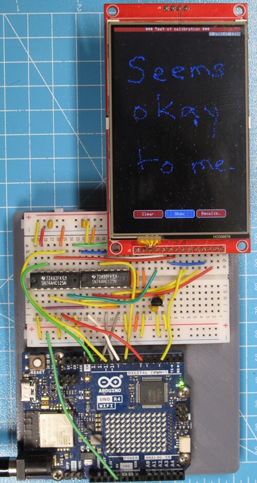

Didn't have a 9341 with touch, but figured an 9486 with touch wouldn't be far off the mark.
The picture speaks for itself, I believe. No ChatGPT fluffing, no generic diagrams of other's wiring, no inscrutable Fritzing, just the hardware working.
Oh, and of course, a dedicated 3.3V regulator, hardware SPI with active level shifting, the display's untrustworthy MISO pin properly tri-stated so that touch works (and the SD card if I wanted to use it), all that good stuff.

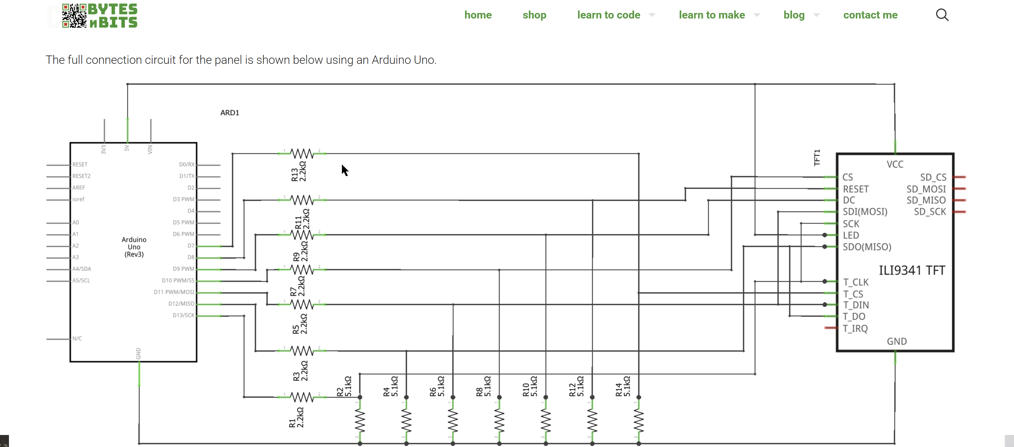

From your schematic you are driving a 5V input with 3V3, that does not always work. Try using a level translator. This is supported by the fact that a 5V processor works.

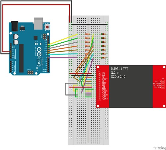

Your Fritz picture does not match the schematic in that you have added a voltage divider also in the screen's T_DO and MISO lines with an extra 5.1k resistor. This is incorrect because these are 3v3 outputs from the screen feeding a 5 volt Arduino. If anything these should be level shifted upwards, not downwards. If it worked on a Uno R3 then it was probably luck. It would appear the Uno WiFi R4 is more sensitive. The schematic itself is anyway not nice as @gilshultz has pointed out.
Edit.
I've looked again. The schematic (difficult to follow) is indeed wrong. R4 should be omitted.
