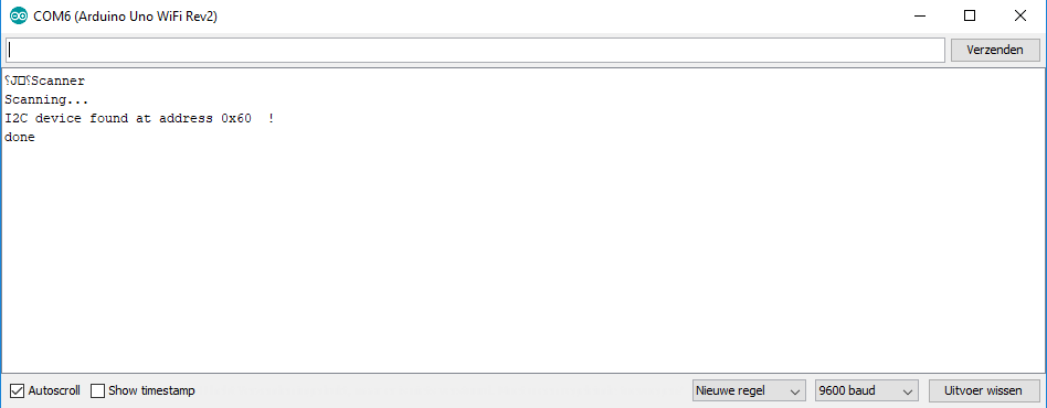

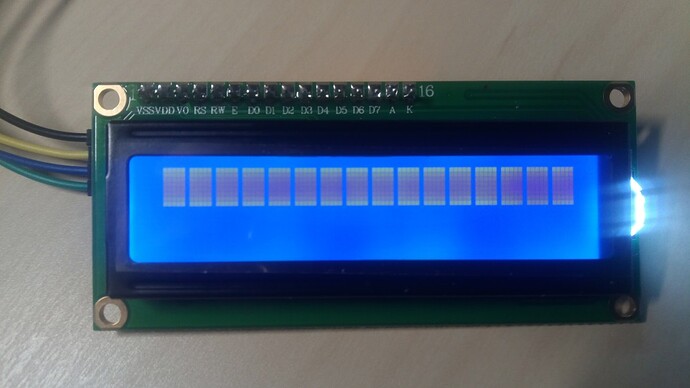

Hey, i'm new to arduino and ran into a problem i'm unable to fix. I just bought a Arduino Uno wifi rev 2 for a wifi project i'm making. For this project i also bought a I2C LCD display. But i can't get the LCD display to work(it lights up but doesn't show any text). I'm using the Wire.h and LiquidCrystal_I2C.h libary from within the IDE. The only warning i get is that the libary could be incompatible with the megaavr. I've tried diffrent version of the libary but same result. Currently using version 1.1.2. I've also tried the wire scanner and it showed up with the 0x60 adress
I know of no LCD with an I2C backpack that uses that address. Can you post a photo of the LCD? Front and back sides, please.
Yes i used the 'hd44780 > ioClass > hd44750_I2Cexp > helloWorld' example. I'm using version 1.8.8 of the IDE and the board i use is the arduino uno wifi rev2. I've also selected the ATMEGA382. I've attached the photos of the LCD as well as the output of the Wire scanner
I did a bit of poking around and find that the processor on the arduino uno wifi rev2 is not Mega328 (it's a ATMEGA4809) so can have issues with programs that access certain registers.

I guess the I2C address 0x60 which the scanner found was either for the ECC608 crypto chip or for the NINA-W132 WiFi BLE module. The full data sheet for the ECC608 is available only under a non disclosure agreement, but from the summary it appears that its I2C address can be programmed and the default address is not stated. From the NINA-W132 (R05) datasheet, if I read it correctly, the pins which are connected to the I2C bus are marked as reserved for future use!
