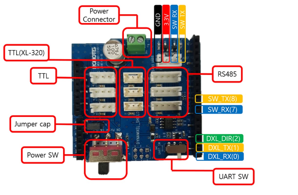

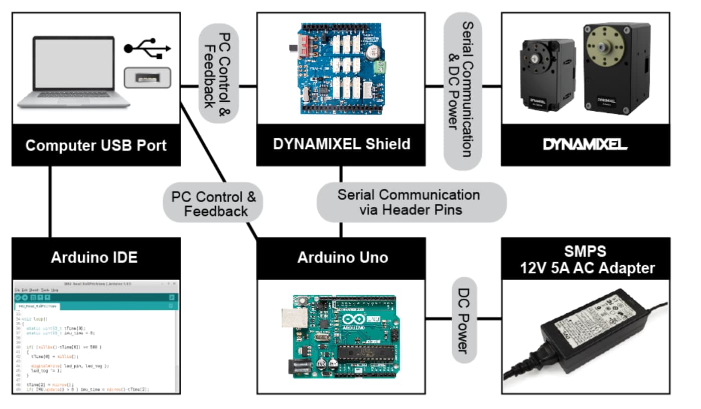

I connect the Servo with Shield and Arduino so
I don't know your shield but first page of documentations tells :
Specifications
Item Details
Operating Voltage 5 V (XL-330) ~ 24 V (PRO / X Series)
Maximum Current 1 A(Arduino), 10 A (Terminal Connector)
Your servo has stall current of 2.3A.
So you need to power it through shield terminal connector (and set switch/jumper accordingly).
i used this Shiled:
All Info about Shield can you be here: DYNAMIXEL Shield
The Jumper Cup is desconnect and the shield is connect to external power supply with enough current
