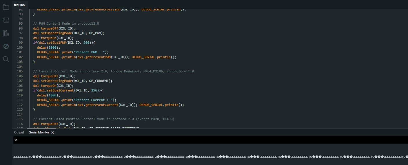

Hello, I am using an Arduino Mega 2560 with a Dynamixel Shield to control a Dynamixel AX-12A Servomotor. Whenever I try to run sample code from the DynamixelShield Library (see Github here), there are random characters printed to the serial communication. Also, the motor doesn't function at all despite the power light turning on. How do I get the motor to work, or even communicate correctly? Here is an image of the issue:

  1. AX model DYNAMIXEL servos use protocol 1 communications. You'll need to modify the example sketch to use protocol 1 by changing const float DXL_PROTOCOL_VERSION = 2.0 to const float DXL_PROTOCOL_VERSION = 1.0
  2. In order to access the debug serial port on the DYNAMIXEL shield, you need a serial to USB adapter connected to the UART output on the top of the shield, the standard hardware serial used by debug is used to control the DYNAMIXEL servos.
