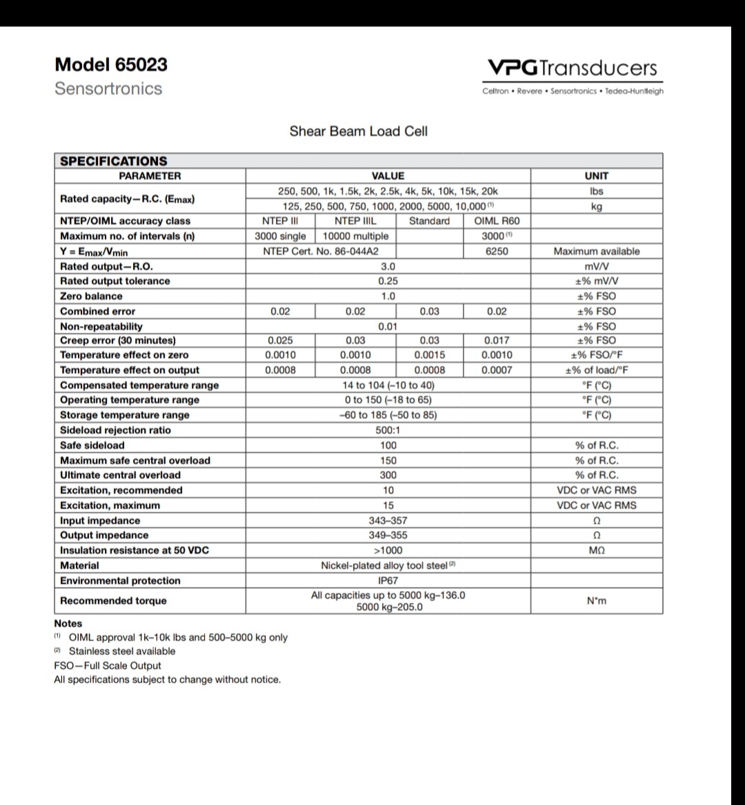

am interfacing arduino uno with load cell by using AD620. (Analog Monitor to Serial Output).

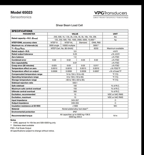

Loadcell technical information is attached here. Excitation voltage is given 10 - 15VDC.
When am interfaced with AD620 the output is varying around 140mV when load cell is in idle condition (placed on table) . Please refer the analog output of AD620 module with arduino analog input. is it noise signal or did i missed something ?

HX711 should be fine. With your cell's 3 mV/V sensitivity and the HX711's 128 gain, at full load, you'll be using a fair bit of the HX711's bandwidth.

The noise is probably coming from the DC-DC converter, HX711 would be a better solution.
I would put a 0.1uF capacitor as bypass across the E- and E+ connections at the loadcell.
