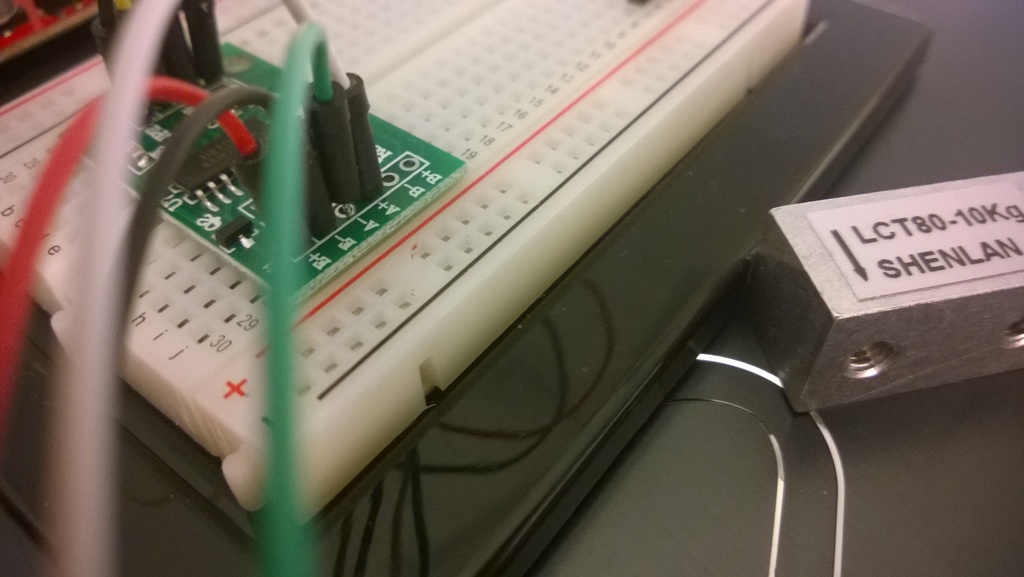

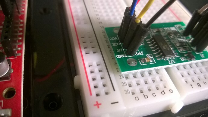

Here are a few photos of my setup. I hope this is clear.

In your photo 004-2, it looks like your jumper pin at A- is just poking through the hole in the HX711 board into the proto board. Is that what you've done? If so, it's no wonder nothing is working. You need to solder pins at all of the HX711 holes you're using, then then use female jumpers to those pins.
Thanks, Dave, (or should I say "the Edge"?
Normally the pin at A- is not sticking up. But regardless, will the Hx711 simply not work without the wires being soldered to it?
It's highly unlikely to work without soldered connections, and even if it did, it would be erratic and unreliable.

That was it! A little solder did the trick! Thanks to all!
