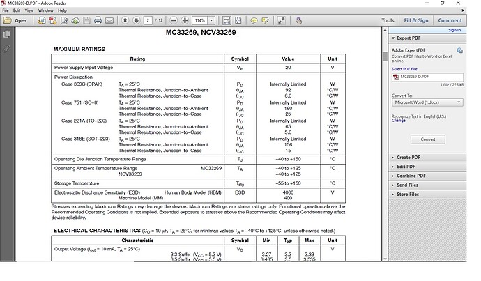

Do you refer to the voltage drop across R1? I'm not sure if I'm reading the data sheet of MC33269 correctly. Is the max Vin = 20V?

Indeed the absolute max vin is 20 volts.
Expect impressive effects when it's fed with something like 20.5 volts.
So make sure you have ample of margin towards that 20 volts maximum.
