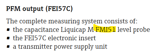

is this the equipment your are using:
or this one?
coz its the latter that mentions fmi51 and this setup outputs Pulse-frequency modulation (PFM)
