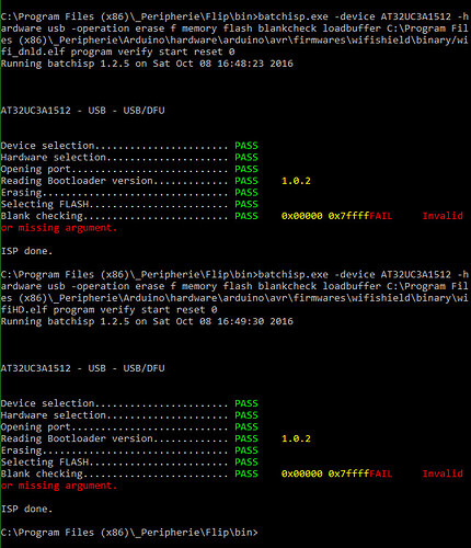

At the beginning all seamed to work well, only that this mention appeared on the serial monitor: "Please upgrade the firmware". I found the necessary information on the web (Flip, USB upgrade, command line strings and so on) to do this. It seemed to work (7 times PASS, bootloader version 1.0.2) but after the last one, "Blank checking ... PASS" there appeared the following in yellow: "0x00000 0x7ffff" and then in red: "FAIL Invalid or missing argument."

I could solve the problem by changing the path designation in the command line (see the picture CMD.jpg), where the spaces in "C:\Porgram Files (x86) ..." caused the failing. I used a relative path designation.
