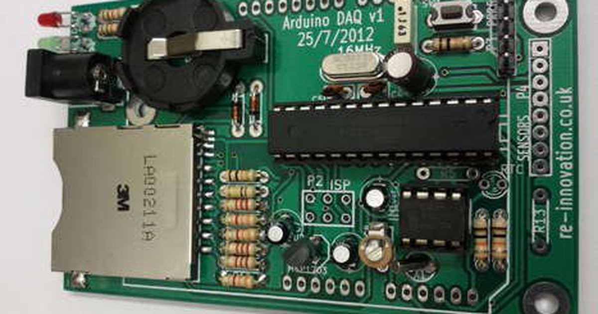

As said, I have one... Uno with crystal... bought mine about 4 years ago, I had to pay RMB 20 for it. Gotten quite a bit cheaper!
You say you've been looking for weeks? Where have you been hunting? You do have to do a little digging, but the full schematics and parts list are available online for all the official Arduino models. The Pro Micro has a crystal oscillator, for example. If you look on any online store like AliExpress or Ebay, you will find hundreds of UNO, Nano, clones ... many of them have replaced the ceramic resonator with a crystal part. You can easily see the difference visually. The crystals come in a different package.
Here's one example of an UNO clone with quartz crystal:
Not a product recommendation, just showing you what you can obtain.

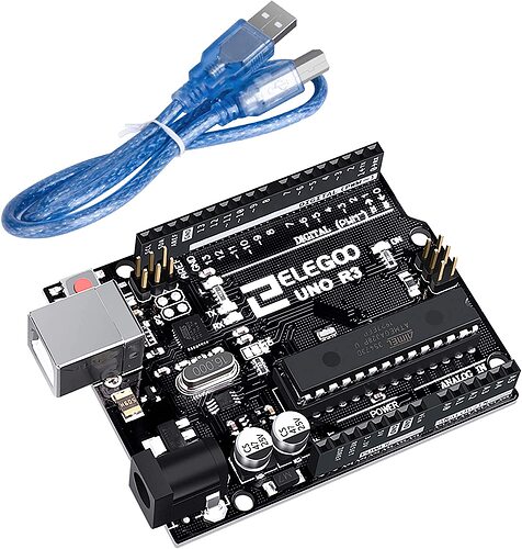

This is the board I am using:
Perhaps that silver thing already is a crystal oscillator in which case the question is can I can one with a more accurate oscillator? Everything I read says the Uno has ceramic one. I've search loads on AliExpress and other sites and couldnt find anything specifically saying crystal or more accurate millis.

You have to look for a board with two crystals: one is for the USB chip (I see an SMD part with Atmel on it, I guess that's the 32U2 taking care of the USB connection, no doubt the crystal belongs to that chip) and is present on all boards, and one for the ATmega328P. Just as you can see in the links I and aarg posted.
It seems that the Unos using the DIP package of the '328P tend to have a ceramic oscillator; the clones that use the TQFP package often (but not always) have a second crystal oscillator.
