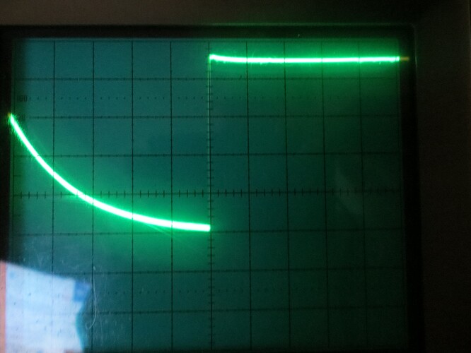

I am trying to read in data serially from the RX port, then Transmit data using that received data. I currently use the functions Serial.read for the receiving and Serial.write for the Serial transmission. The problem I am having is when I scoped the output from the TX port, it is a curved waveform.
It basically looks like one positive decaying exponential and one negative decaying exponential. They are symmetric across the y and x axis'. The picture is not mine, but it looks similar to this.
I have scoped the input, and scoured the data sheet and such with no avail, any help would be much appreciated! :slight_smile:

EDIT:
I would prefer to stick to UART, it works better with my system. Also I have tried powering through DC and USB to no avail. I am using an actual Arduino Zero not a clone or genuino or MO.
Thanks Again!

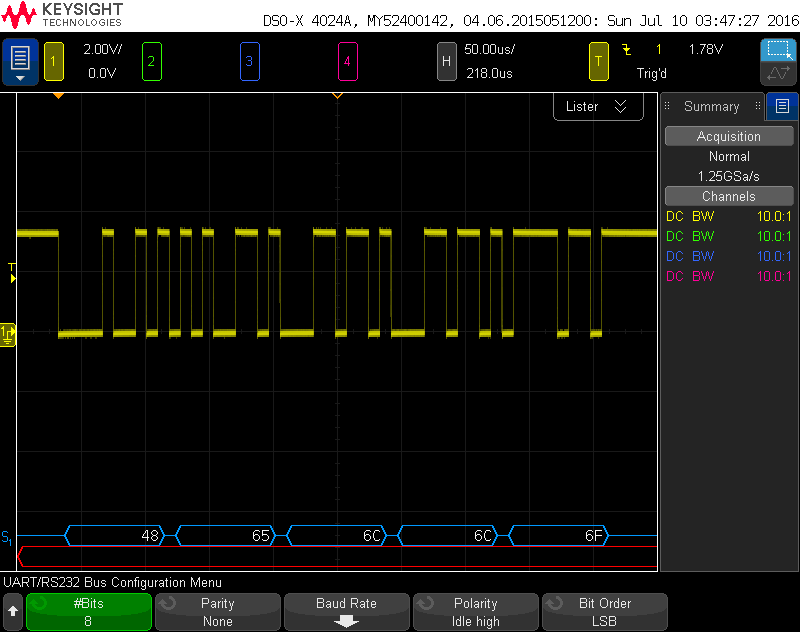

Out of curiosity (and a little time to kill), I decided to try this here. Since you didn't give any specific code, I tried this:
  Serial1.begin(115200);
  Serial1.print("Hello");
  delay(5);
Here's the waveform I see when I connect my scope to pin 1.

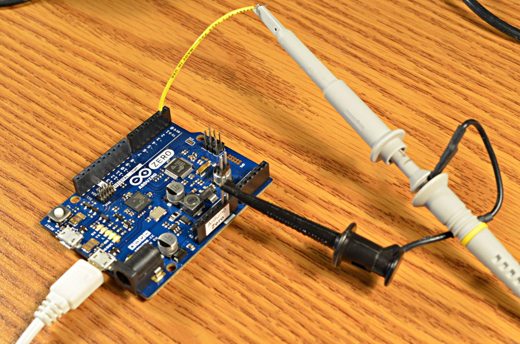

How I tested, if anyone's curious.
