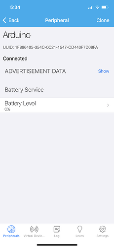

I am writing a custom library (with a custom service and two custom characteristics) which uses the ArduinoBLE library.
Running the code on Nano 33 iot all the characteristics are present and everything works as expected:
but when it runs on Uno R4 WiFi the custom characteristics are not included in the service:
I have already updated the radio module to V: 0.2.0 and updated the ArduinoBLE library (following instructions here: Radio module firmware version 0.2.0 is now available.
Below my code (simplified).
