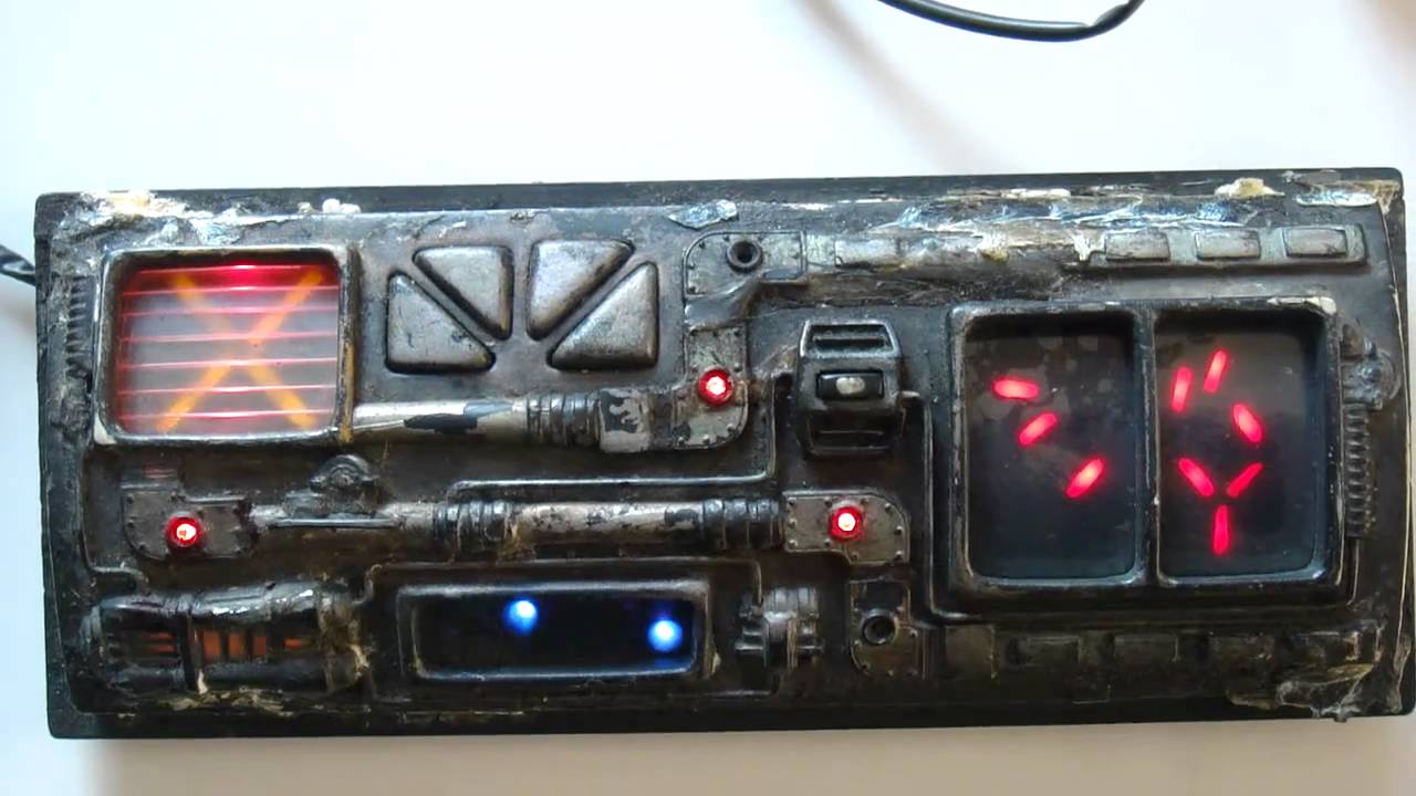

Despite having more of these made, I am still looking for other options. My boards are 2"x2" and and as such won't fit comfortably in certain props, like this Predator computer gauntlet which is the kit I am presently working on:
