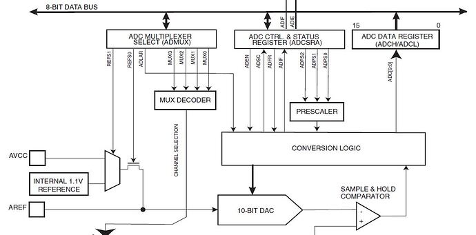

I'm trying to understand the REF pins by reads and I've assumed my own thoughts for lack there of.

According to the schematic for the Uno IOREF is directly connected to the 5v pin.
AREF is for an external voltage reference for the analog to digital converter. The Atmega 328 datasheet will have all the details.

On the Uno, AREF is an open pin with a capacitor to Gnd.
Internally the pin connects to the Analog Input multiplexer.
The default setting for the ADC comparison voltage ie External, which routes the AVCC signal thru the mux. The cap on AREF thus helps the voltage to be stable, and perhaps less noisy.
When Internal is selected, the 1.1V internal voltage reference is routed instead.
I'm not sure what to select to use neither AVCC or the 1.1V reference and to use a voltage applied to AREF instead.
The IOREF pin was intended to provide the IO level being used on the main board to any daughter boards, so they could supposedly supply 3.3V signal or 5V signals on their IO pins. I am not personally aware of any shields that can switch back and forth.

The Aref pin on an Uno is nothing more than the ability to gain access to the reference voltage of the A/D converter.
It is normally internally switched to VCC (default 5volt Aref).
It can be switched to an internal 1.1volt reference voltage, or it can be internally disconnected so you can connect an external reference voltage to it.
IOREF is nothing more than a connection to VCC (the power supply) of the processor, 5volt on an Uno,
so a connected shield knows what logic signals to provide or to expect.
You can use this pin as a 5volt pin, in case you need more.
A Due (3.3volt logic) has IOREF connected to the 3.3volt VCC.
