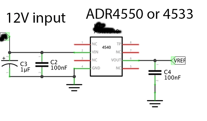

I use an analogic reference (ADR4540) pin for better noise handling on analogic measurement. I bought the ADR4550 and 4533 and made a simple circuit with two 100nF capacitors and a 1uF capacitor as suggested on the datasheet.

Is it possible to apply 5V to AREF ?
What if the processor runs at 4.99V and you apply 5.01V to AREF ?
Why would an external voltage have influence on the noise ? There is already a ferrite bead and a capacitor for the AREF. If the 5V is not doing something crazy, then that should be good enough.
The noise can be reduced by averaging/oversampling in software.
According to the datasheets, the Aref IC can apply a maximum of 5.001V since a B-grade IC. Considering the resistance of the wires at the processor should not arrive at more than 5V

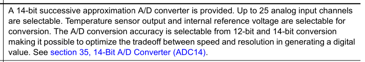

I read some more about the ADC.
According to the datasheet, the processor can do both 12 and 14 bit:
The special settings for the UNO R4 Minima are here: https://github.com/arduino/ArduinoCore-renesas/tree/main/variants/MINIMA
I assume that setting the resolution to 14 bits should work.

I still don't like a 5V reference. What is the USB has bad contacts and there is only 4.2V from the USB. How will the ADC behave with such a high reference ?

Thank you for the clarification. A reference of 3.3V or 4.096V makes more sense.

The Minima has a diode in series with the USB +5V in, so is running at about 4.7 volts.
Therefor to make use of the Aref input one has to have a reference that is lower, I use 4.096V ref chip. Note however one also has to make sure that the circuit that is supplying the analog-input is also stable - if one is using a 10K pot for example the hot side also needs to be on the Aref, NOT the nominal +5V pin.
