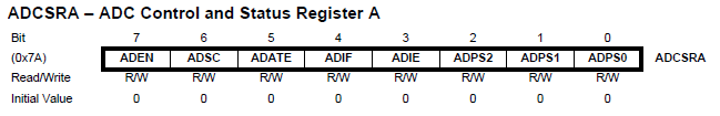

Arduino and Third Party Libraries do not always serve the specific purpose of a user; this is the case when a user needs to write register level codes as you tried to measure the value of Band Gap Voltage (1.1 V Internal) which is connected with Ch-14 of the MUX of the internal ADC (Fig-1 that belongs to UNO).
Figure-1: Structure od ADC of ATmega328P MCU
1. int x = analogRead(arg); supports only A0 - A5 (ADC Ch-0 to Ch-5) for the argument field. Therefore, one has to use ADMUX and other registers to acquire the signal from Ch-14.
2. The popular register level codes are:
(1) Enable ADC and 125 KHz conversion cloak (clkADC) with the help of ADCSRA Register
Figure-2: Bit map of ADCSRA Register
(2) Select voltage for VREF (1.1V internal) pin of ADC using of ADMUX Register.
(3) Select Ch-14 with the help of ADMUX Register.
Figure-3: Bit map of ADMUX Register
(4) Start ADC with the help of ADCSRA Register.
(5) Wit until conversion is done by polling the ADSC or ADIF flag of ADCSRA Register.
(6) Read ADC data by executing appropriate codes.

3. Instruction coding for the text codes of Step-2
  ADCSRA = 0b10000111;  //covers: Step-2(1)
  ADMUX = 0b11001110;    //Covers: Step-2(2) and 2(3)
  byte x = ADCSRA;  //covers: Step-2(4)
  x = x | 0b01000000; //covers: Step-2(4)
  ADCSRA = x;
  while (bitRead(ADCSRA, ADSC) != LOW) //covers: Step-2(5)
  int y = ADCW;   //covers: Step-2(6)
  float z = (float)(1.1 / 1023.0) * y;  //covers: Step-2(7)
  Serial.print("Value of Internal 1.1V is found as: ");
  Serial.print(z, 1);
  Serial.println(" V");
