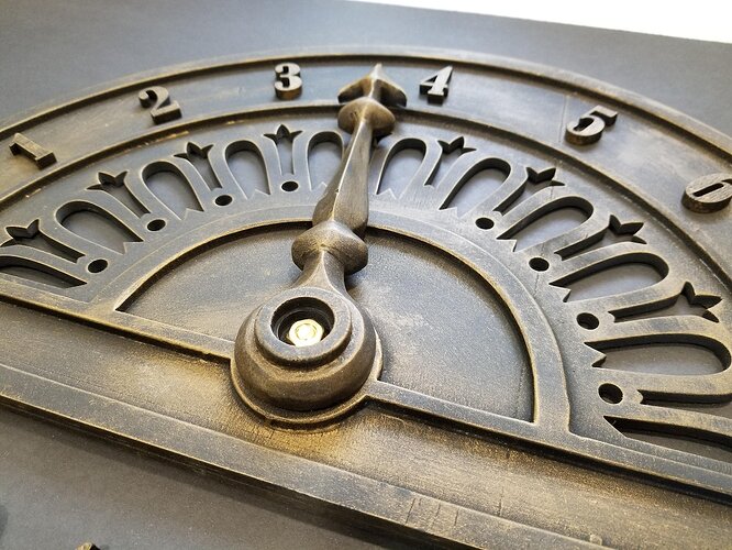

I want to start off by saying I have zero knowledge in this area and am reaching out to hopefully find some assistance. I am an artist and have an idea for an art installation that requires electronic components. I’ve made an elevator painting and I’m trying to have elevator-like elements for the viewer to interact with. Essentially as the viewer pretending you’re using an elevator, you push a button and an elevator level indicator spins.
A little more detail, there will be 8 led momentary push buttons all with the same function. Once you push the button the elevator arrow turns clockwise in a complete circle, about 4 revolutions per minute, nothing super fast. (I thought it’d be more fun if the semi circle indicator’s arrow rotated fully.)
Here’s a video demonstrating the elevator level indicator rotation.
I have a link of the style of led buttons I'm interested in, but am unsure of the voltage/amps and if there’s a better website other than amazon.
https://www.amazon.com/warranty-Momentary-Stainless-Mounting-Self-reset/dp/B07Q2HNZCX/ref=sr_1_14?crid=8B30J4E2GGIS&keywords=led%2Bmomentary%2Bpush%2Bbutton%2Byellow&qid=1707099820&sprefix=led%2Bmomentary%2Bpush%2Bbutton%2Byellow%2Caps%2C106&sr=8-14&th=1
Here is a link to the physical elevator level dial. I was thinking it would work to somehow attach a motor to the back of the arrow so it can spin.
I’m not sure where to start, or if this is even the right place to ask for help. I did some research and it seems like using an Arduino might work, but have no clue which kind, and if that would be correct.
Please let me know what important information I’m withholding to make your life easier in understanding what I’m going for. Thank you to anyone that reads this :slight_smile:

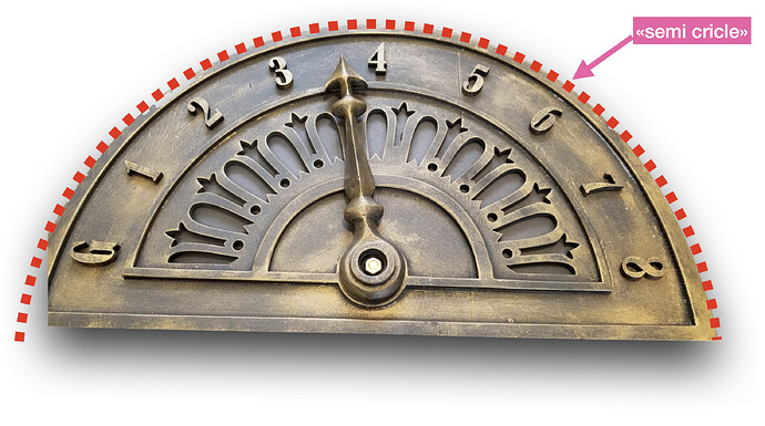

What is that? I just see a single clock hand.

Thanks, makes sense. I’d hastily assumed the video was made by the OP.
