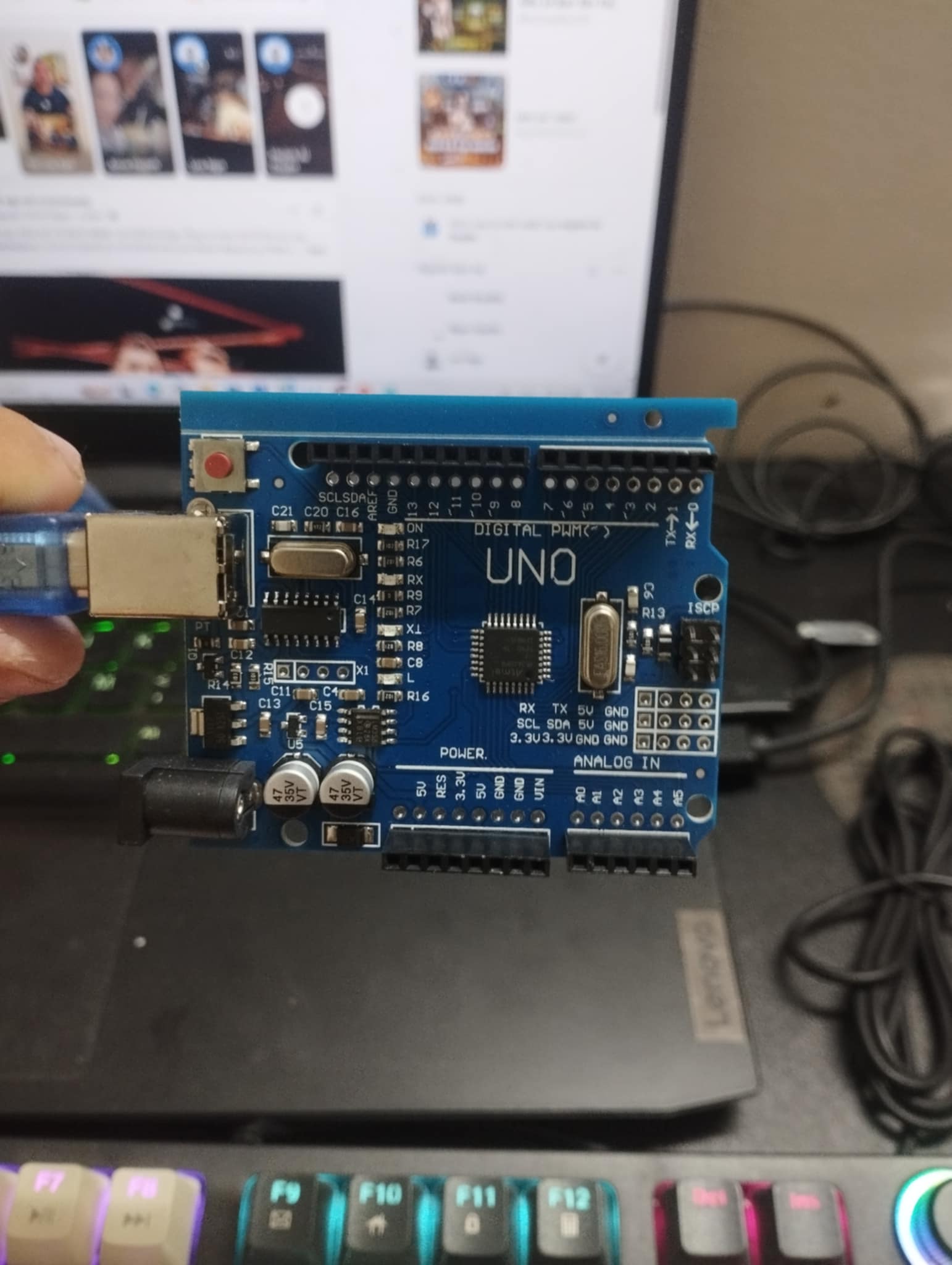

I just starting to learn Arduino coding and have some problem, may anyone help me to clarify why i can't upload my code to Uno please ?

To your question, please verify that your arduino is on the selected com port and that (if needed since you are using a clone) you have the correct serial driver.

i don't know how to set up Arduino, where to get serial driver. I selected all correct to my port, but it still not working
Hi @kdhihi. The "can't set com-state" error occurs when uploading to the boards that use specific batches of the WCH CH340 USB chip. The problem only occurs when using the latest version of the CH340 driver.
The workaround for the problem is to perform a "roll back" to an older version of the driver that is compatible with these problematic "CH340" chips. I'll provide instructions you can follow to do that:

Thanks for your instruction. But at 18.3 it says "the best drivers are already installed"
I have found that when the driver installation gets into this state, it can be solved by uninstalling and then reinstalling the drivers. After that, the "roll back" option should be enabled.
