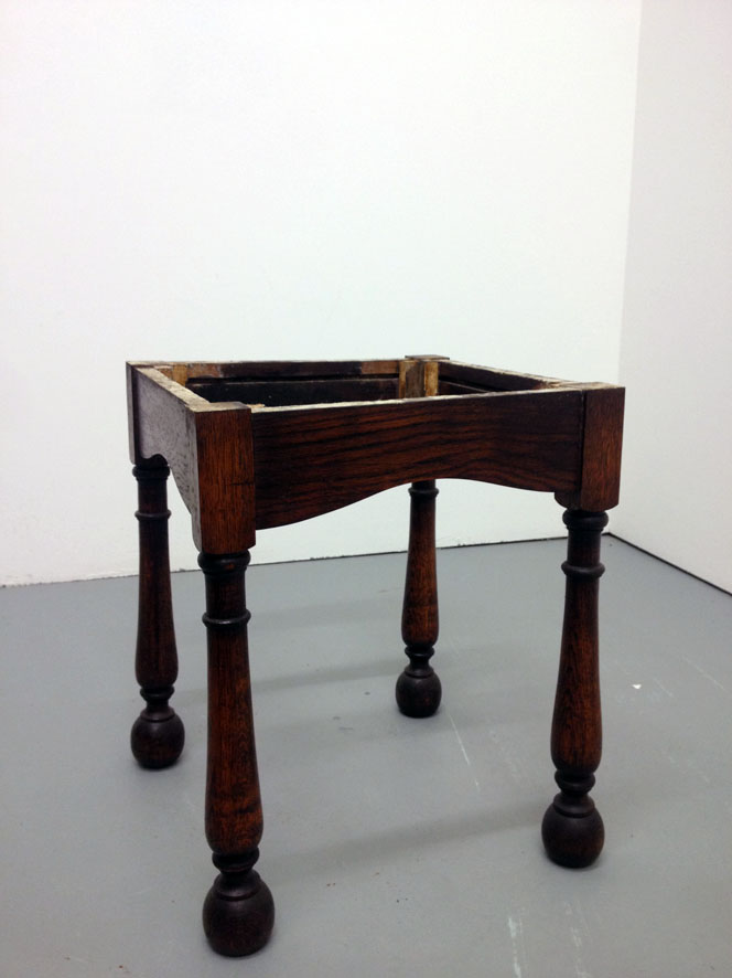

In a nutshell, I would like to programme a stepper motor to rotate the top of a table at a very specific speed- one ration corresponding to the time it takes for the Planet Saturn to make a full rotation. 10 hours and 39 minutes.
The accuracy of the rotation is quite important and so is the smoothness- if possible I would like it to move imperceptibly.
The table is a small coffee table – see pics attached. The top of the table weighs approx 3 to 4 kg. (I plan to decrease the weight by routering out the excess of the bottom side. Once done I hope it should weigh around 2 ½ kg.
I would like to conceal the motor from view, so the length of the motor is a concern, but the width could be as large as is needed.
If theirs someone out there who’s interested, I would very much appreciate help with feasibility, recommendations on hardware to purchase and complete programming/coding.
It would also be a great to find someone not to far away in the uk.

Stepper motors move in steps. You can have very long intervals between steps for slow movement. if you want to reduce the impact of steps it would probably make sense to use gears so that a single rotation of the motor only moves the table a small amount.
How heavy is your table and how good is the bearing on which it will rotate? Those, and the gearing will affect how much torque you need from the motor.

the table top is hard wood –see previous pics (56cm diameter x 2cm thick) and weighs approx 4kg, once I know where I’m attaching the bearings I plan to decrease its weight by removing excess wood from the bottem side using a router, I hope to get it down to 3 kg.

with a belt drive, a simple worm gear and a belt drive from a scanner, you could easily need to run 3 steps per second.
12:1 on the pulley, 10:1 on the worm and 1/4stepping on the stepper.
ebay has some 27:1 gear head steppers
coupled to a 10:1 belt, you would need to run your stepper at a decent speed. 6 steps a second ?
10hours = 600 minutes, = 36,000 seconds
27:1 x 10:1 = 270:1
200 natural steps x 1/4 stepping is 800 steps
270 * 800 = 216,000 steps per rotaiton
216,000 / 36,000 = 6 steps per second.
very easy to do.
