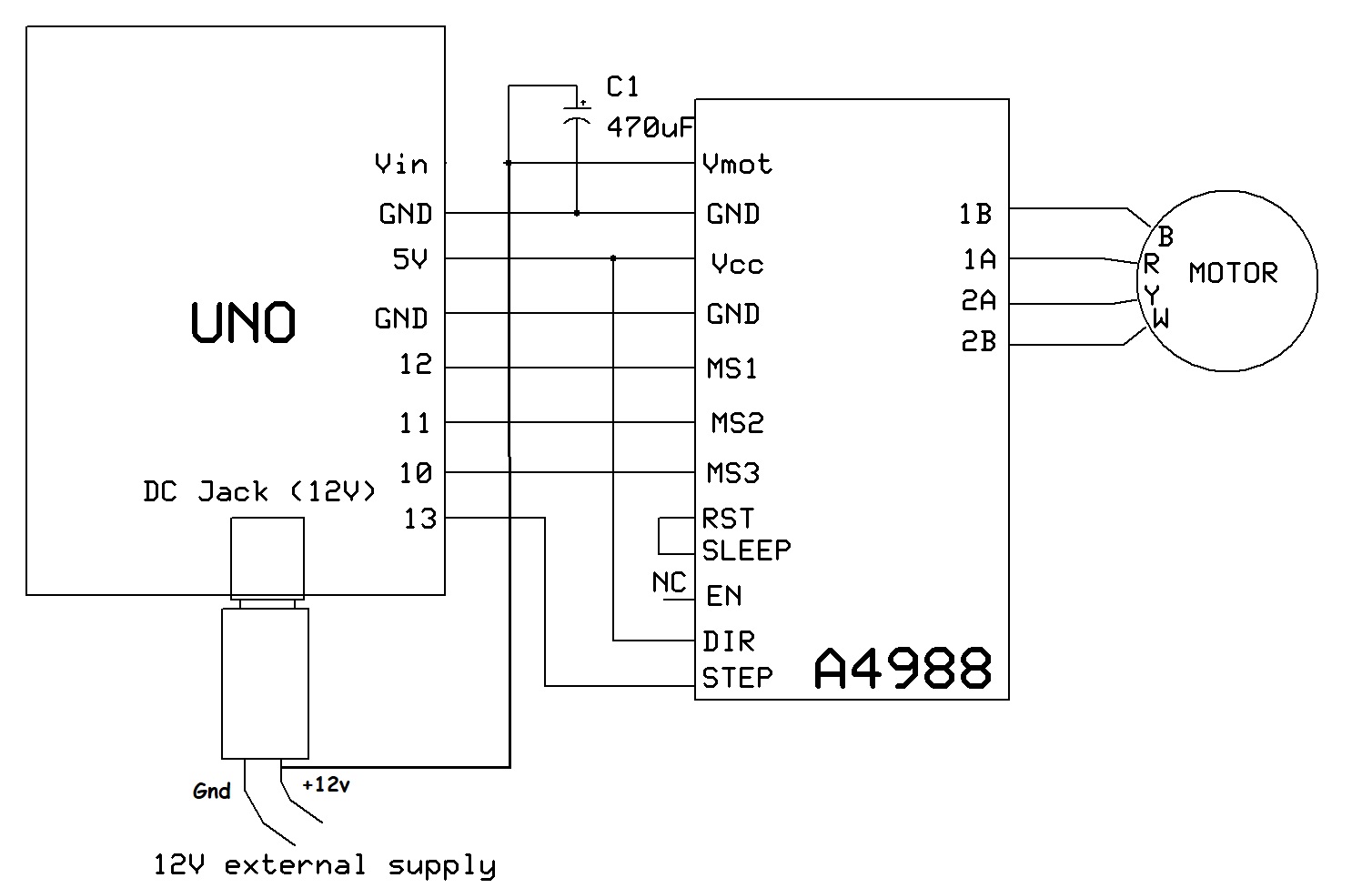

Can you please post a schematic of your project?

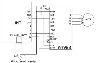

Hello, this is the schematic of my project.
BTW, the driver board is hard-wired for CW operation by tying its DIR pin to Vcc.
So you are using the Vin pin to supply the motor with 12V from the DC jack.
I would advise you connect the Vmot terminal of the A4988 directly to the 12V supply .
You are at the moment running current through a protection diode on the UNO board and its PCB tracks that may not be able to handle the stepper motor current.
What is your 12V power supply?
The 12V supply is from a 12V/1A power adapter belonging to an old router. Note that the motor works even with a 9V/650mA phone power adapter.
The motor is rated for 0.4A - does this still run the risk of damaging the arduino board?
Refer this post comment:
It would be good practice, as your motor current (pulsed) will also be going through the PCB and could cause problems.
In fact this would be better.
