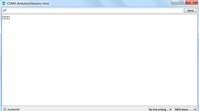

I am trying to send AT commands to ESP8266. I re-flashed ESP8266 as suggested here arduino uno - How to reset ESP8266 wifi module - Arduino Stack Exchange

Below is how my circuit looks like https://i.stack.imgur.com/hgqEl.png

On serial monitor I am trying to send AT commands after uploading above program. I am getting square box on executing each commands.
Can anyone suggest what wrong I am doing ? Thanks in advance
I have tried with different baud rates 9600, 74880 , 115200 also but no success. Can anyone help me what I am doing wrong.
I have tested but its working fine for me, only the change i have made with the baudrate to 115200.
Check your ESP8266 baudrate. check this arduino nano - How to change baudrate of ESP8266 (12e) permanently? - Arduino Stack Exchange
