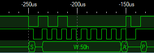

Here's a quick capture of Nick Gammon's I2C scanner with an active device at address 0x50:
It looks like the write bit is being set for each device address. A NAK is detected until address 0x50 is queried where a device exists and an ACK is received.
For completeness, I also ran a scan with Rob Tillaarts I2C scanner library and that too sets the write bit:
That would suggest that your devices "alternate" address should have been found.

Unless I completely messed up, I disproved what I thought was a sound theory back in post #12. From my very basic checks, both Nick Gammon's and Rob Tillaart's I2C scanners put out the address with the R/W bit clear - i.e. a write.
That one byte should have been enough to cause an ACK from the secondary device address according to fig 10-4 of the datasheet (as shown in post #8). I'm at a loss as to why the I2C scanner didn't pick it up.
Well now I'm confused. I thought your scope captures showed the R/W bit set by the scanners, which would be a read.
The LA traces show the R/W bit (the bit just before the ACK or NAK) clear (logic 0) for both I2C scanners - i.e. a write.
I'm still at a loss as to why the "alternate" address wasn't discovered.
