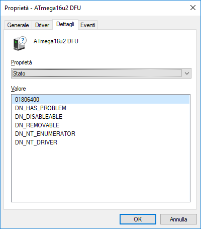

Hi all,
just got my first Arduino starter kit, downloaded and installed latest IDE (1.8.5) on my Win10 64 bit, connected the Arduino Uno board to USB via the provided cable.
The Uno green "on" led and yellow "pin13" led light up (is it normal to get the pin13 led on continuously at start up?) , got a message about configuration of a new device (apparently successful), fired up IDE, checked that "Arduino/Genuino Uno" is selected under "Tools | Board".
BUT: the "Tools | Port" menu is grayed out and, in Device Manager, ATmega 16u2 DFU (the USB controller, I believe) is under "Other devices" with a yellow warning icon and no driver installed.
So I tried to install the driver manually, selecting the Drivers directory under C:\Programs (x86)\Arduino and selecting the "look in subfolders" option: says it cannot find a driver for my device.
Also tried to right click and select Install on the arduino.inf file in the Drivers directory: says "Installation complete", but still the driver for the ATmega 16u2 DFU device is not installed.
Tried uninstalling everything, cleaning up with ccleaner and starting over: same result.
What can I try next?

A more specific information is the Hardware ID of the connected device.
Are you certain your board has the 16u2 chip? A lot of the "official" boards are actually clones with CH340G chip, loose interpretation of the word official.

Please find attached screenshots of the notifications I get when I first plug in the Uno, of the Device Manager and of the Properties tabs of the ATmega16u2 DFU device after installation. I agree with you those notifications have very poor information content, especially considering the device was not installed correctly, but you should complain to Microsoft, not to me. I'm trying my best to describe my problem in order to get useful suggestions (for which I am very grateful).

The hardware ID reported by Device Manager is:
USB\VID_03EB&PID_2FEF&REV_0000
It also reports problem code 0000001C - problem status "No compatible driver for this device" C0000490

In this page you can download the installer from Microship
FLIP
Download “FLIP 3.4.7.112 for Windows (requires Java Runtime Environment)” or another more updated.
Use WinRAR or 7-zip (prefered) to extract the .exe. Driver is inside and I think it is signed.
You can download more updated drivers from LibUSB-Win32 but I don't think they are signed.

I installed "atmel_usb_dfu.inf" from the "usb" directory extracted from the installer. Driver signed by Atmel Norway, version 1.2.2.0 dating back to 2010.
Now the ATmega16U2 appears in Device Manager under a new "libusb-win32 devices" type and looks correctly installed (problem code "00000000"), but the IDE still cannot connect to the board with a greyed-out (disabled) "Tools | Port" menu.
So progress, but still no joy... :frowning:
