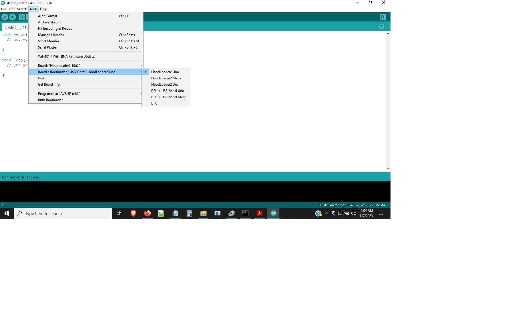

Are you sure you are loading the bootloader correctly - the error suggests to me you selected UNO when loading the bootloader rather than mega ( which I think is your destination board ?)
Here is a screen shot of how I have things set..
I am 75 just learning.
I do have have it set to HoodLoader 2 UNO.
Do I have to set it to HoodLoader2 Mega for the atmega16u2?

I am trying to load a new bootloader to the Atmega16U2 and it will not work, .it will NOT go into the DFU mode. I can not get it to accept any code.
That is what I need help with.
